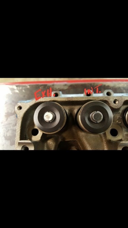

I finished all of the machine work on my heads in order to change to a different spring. Had to wait for a back ordered set of springs. Finally I'm back to the heads and find out that I have the wrong valve stem locks for the exhaust. They are for .375 and not .372 stem diameter. It definitely makes a difference. So I'll have to find some locally tomorrow or order some from Summit. It's on hold again!
I'm wondering why there are .375 and .372 valve stems. Is the .372 factory and the .375 is used when cleaning up valve guides when rebuilding?

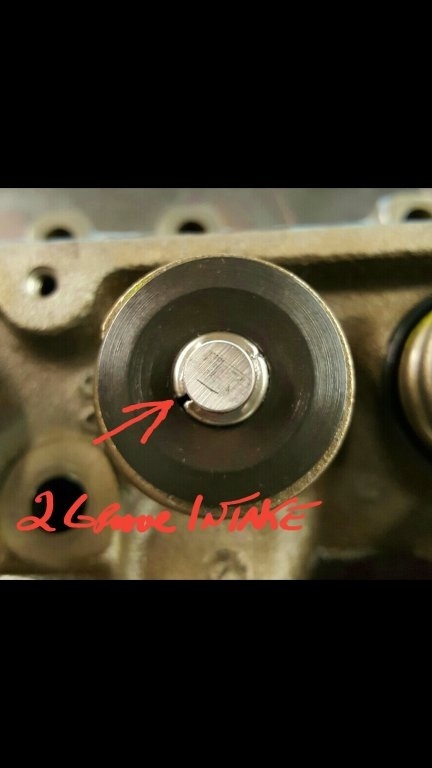

You can see these are correct. They have a gap.

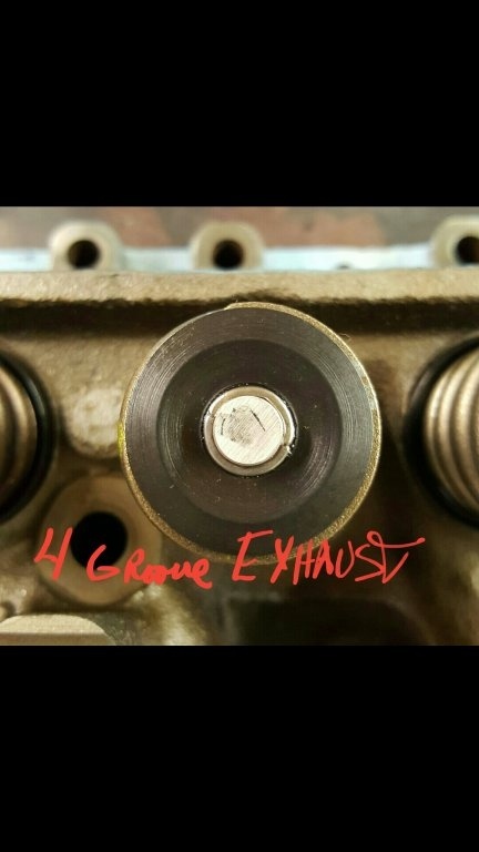

You can see these are touching and not allowing for proper clamping that is necessary.

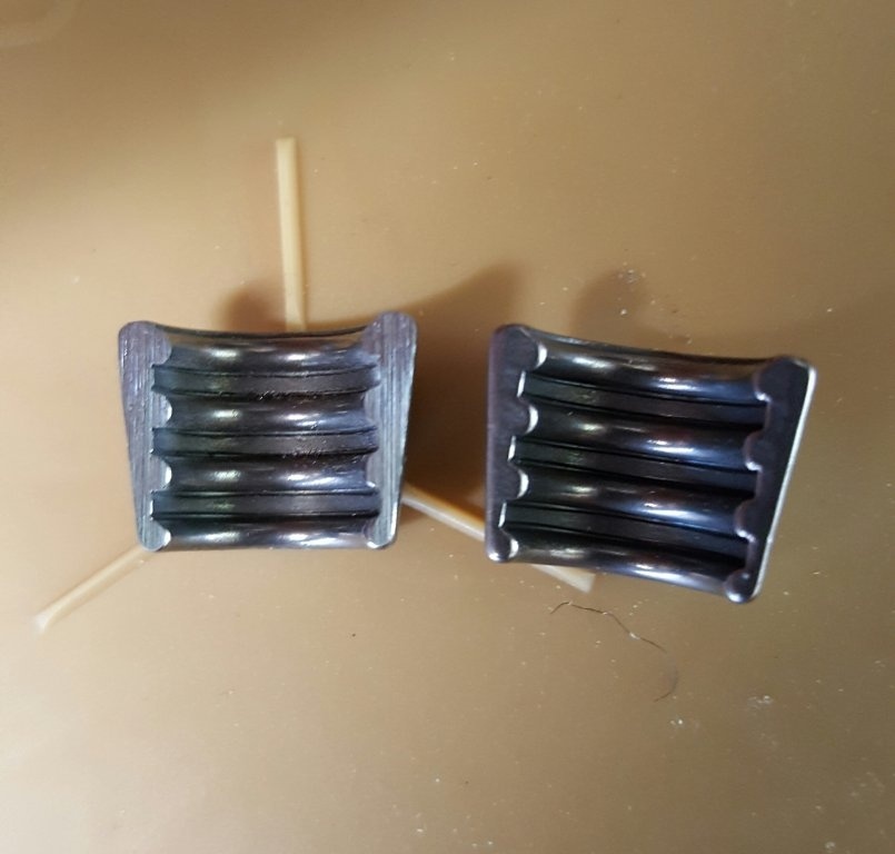

Ok, waited two days on another set of valve stem locks for a .372 valve stem. Installed them on a exhaust valve and they touch together before they "clamp". The valve stem spins inside them. The intake clamps just fine with a gap like it suppose to have. I even took a valve spring off of a old 413 head and they are the same.
So there might be a reason for this? It has to do with the machining of the valve stem or the locks? The grooves don't suppose to take the weight of the retainer, the locks suppose to clamp the stem just like a collet.

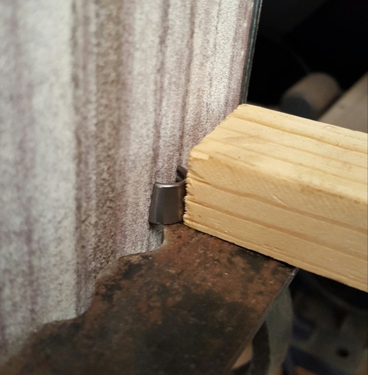

So I took things into my own hands and removed just a couple thousands off of each exhaust lock with my belt sander. Now they hold like they suppose to. I'm just hoping that they weren't designed to spin in the locks like I kept finding.
UPDATE: 05/19/16
Well I should have known. Doing a little reading last night, I come across this. The exhaust locks are designed to let the valve spin.
Well let's call this an experiment and I'm leaving them "as is". If I have problems with carbon build up, I'll just change them out. They have a better grip as is and we're useing a higher lift cam than stock. Now we know!
