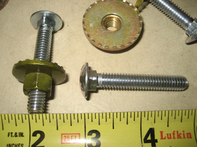

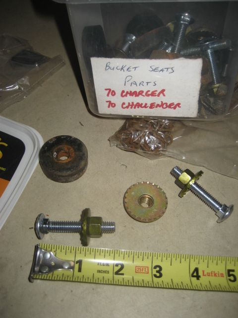

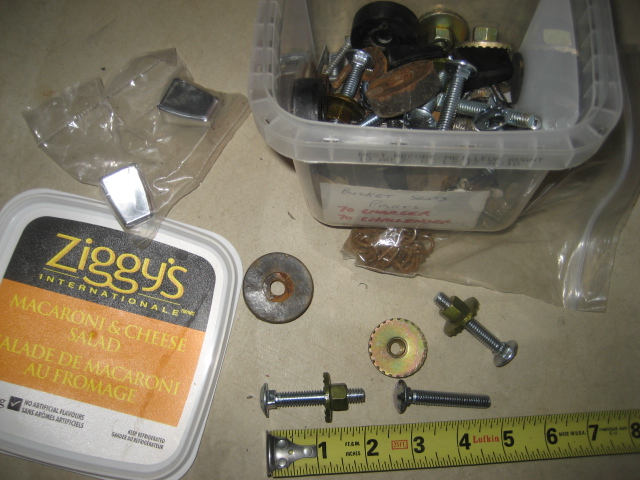

When I restore seat tracks I use 5/16th`s x 2 inch, carriage bolts, that I get at the local hardware store. Clean off the head of the broken stud & the hole remaining in the bracket is square & the bolt just below the cap is a perfect fit. Just drop it in & a couple mig weld tacks & black paint on the cap & it looks great. :icon_thumleft: Hope this was helpful.

That is called a carriage bolt, which is what I was going say is the ideal 'fix'.
