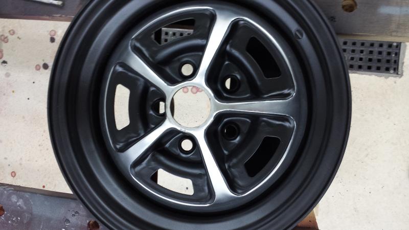

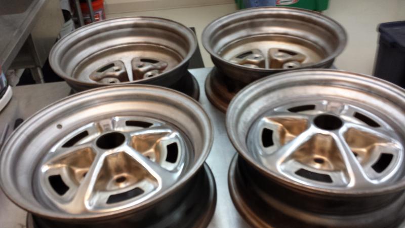

Here are a fewphotos if anyone is interested in the process.
Masked chrome with gorilla tape before sandblasting.
After sandblasting. We removed the gorilla tape and used regular mask to get a better edge before applying Eastwood Epoxy black primer and 2K Ceramic chassis black satin.
Finished product.

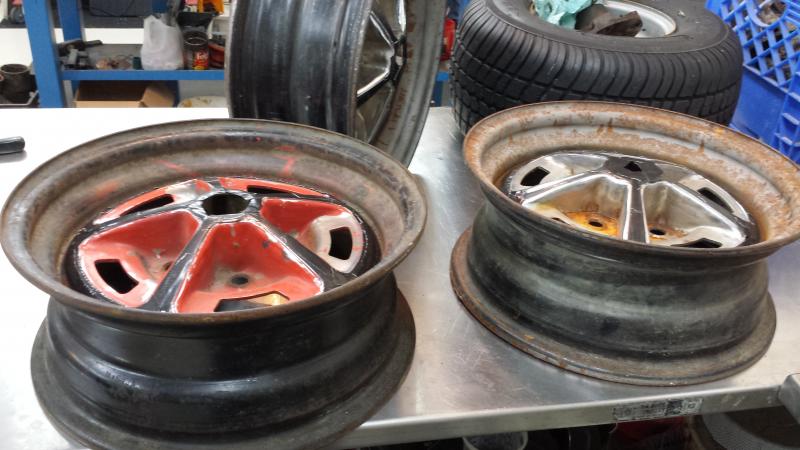

Was the red on those from the factory?

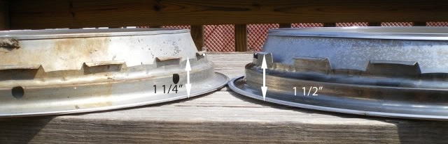

Here's an update on my search. I've contacted all of the aftermarket wheel sources that I'm aware of, and none of them sell a MOPAR trim ring that fits the 14X5.5" wheel. The problem appears that the rings were designed to fit a 6" wheel, and on the 5.5" wheel they will not sit down against the wheel rim, but stick out almost 1/2". Many of them sell "universal" trim rings, but the ones I've seen completely change the look: too narrow (1.5-2"), polished, with an open valve stem hole (as opposed to the OEM: 2.25" wide, brushed, closed valve stem hole). As of now, I'm on the hunt for some driver quality OEM rings so I can get the refinished wheels on the car.
I found a photo online which illustrates the problem:
The ring on the left is a 14" OEM ring (w/o lip), the one on the right was stated to be a MOPAR reproduction ring. Notice that the retention clips on the repro ring are longer, and sit deeper into the wheel (1/4"), which fits the 6" wheel fine, but prevents the ring from setting down on the rim on the 5.5" wheel. The design of the aftermarket rings all appear to be the same, based on the parts that I've measured, and the measurements taken by the dealer reps I've talked to. I've confirmed that the clips on an OEM ring measure 1 1/4"from the rim.
I've contacted the following companies, and these were the results:
Classic Industries: sent a sample. clips measured 1 1/2" below rim.
http://www.classicindustries.com/product/mopar/parts/mw925.html
Coker Tire/Specialty Wheel: Coker acquired Specialty Wheel and now sell the same part. They told me that they also supply the trim ring to Classic industries so there was no need for a sample. http://www.specialtywheel.com/bubble-pack-closed-hole-trim-ring-14x6.html
Wheel Vintiques: They told me that their trim ring does not fit the 5.5" wheel.
http://www.wheelvintiques.com/catalogsearch/result/?q=trim+rings
Stockton Wheel: They supply a universal trim ring. http://www.stocktonwheel.com/accessories.html
Layson's: They were nice enough to measure their trim ring, and it also measures 1 1/2" from the rim to the clips, same as the others.
http://www.laysons.com/Catalog.cfm?nCatID=300&nModelID=17&nModelYear=1969
U.S. Wheel: They only sell universal trim rings. http://www.uswheel.com/collections/accessories/products/trim-ring-1-5-smooth
If anyone knows of another source, please let me know. Otherwise, I'll be hitting the swap meets.

I see that you have the same issue as I do. Apparently the OEM trim ring was designed to fit the 15"X 6.5" wheel, but also was used on the 7" wheel. Now MOPAR and the aftermarket have standardized on the 15"X 7" ring. So you will also have to find a set of OE trim rings if you want the correct look.
When I had a sample of the 14"X6" trim ring, I could see that the profile of the ring fit the wheel OK if you forced the ring down into the wheel. But at that point, the clips are bottoming out in a radius and being bent toward the center. As soon as you let it go, the spring clips pop it back out.
Trying to modify the retaining ring I suspect would be difficult as it appears to be spring steel. It might be possible, but reforming those tabs would be tough, and I think the cost would be excessive.
I believe that there are more hens teeth to be found than '69 14" trim rings. But the OE "lipless" 14" trim rings were produced at least from '70-'74 so I'm optimistic that I can find a usable set.

they seem a bit too bright or polished where the brushed area is supposed to be.
