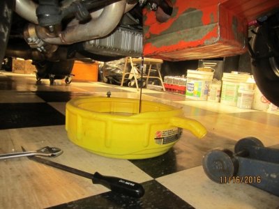

Hung out in the garage today:thumbsup:

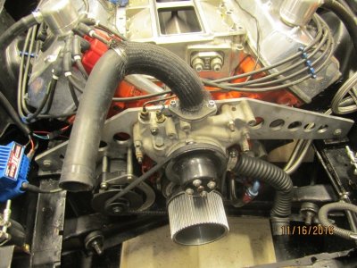

11.14.16 037.jpg 11.16.16 006.jpg 11.16.16 007.jpg 11.16.16 009.jpg 11.16.16 010.jpg 11.16.16 011.jpg 11.16.16 016.jpg

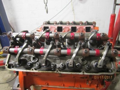

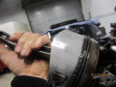

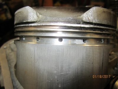

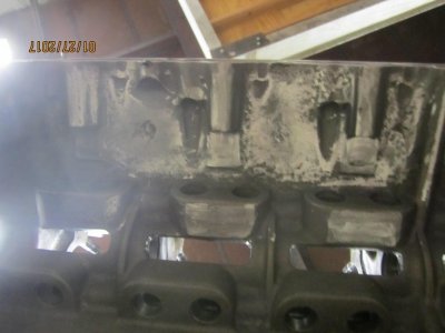

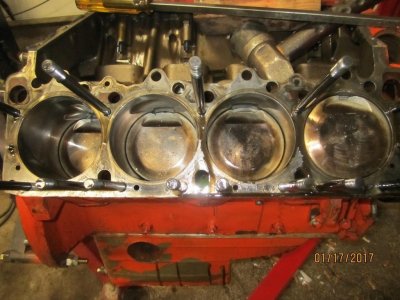

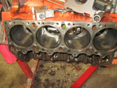

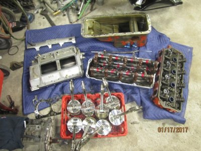

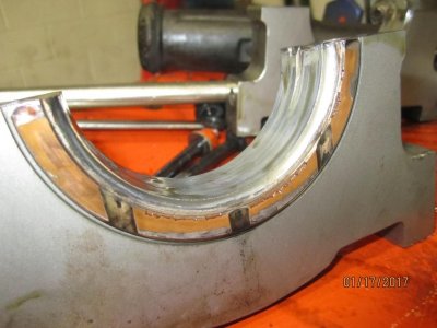

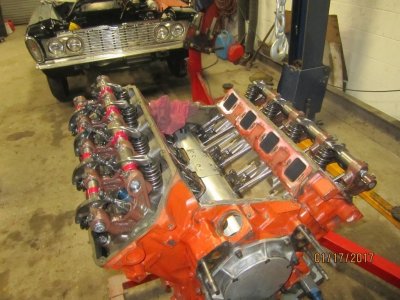

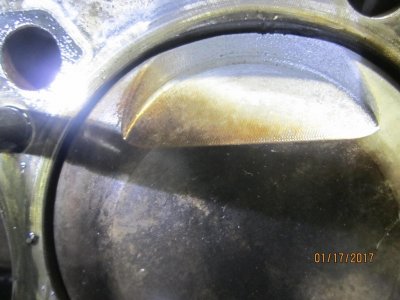

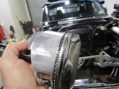

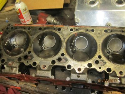

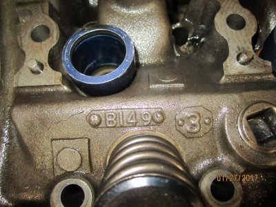

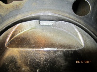

We took it apart and found 4 burnt pistons and a few seconds more would have been 8.That's why it fell off to 9.8:D.CCd the stock iron heads that came off to 170cc,,virgin stock heads!
1.18.17 005.jpg 1.18.17 007.jpg 1.18.17 009.jpg 1.18.17 011.jpg 1.18.17 012.jpg 1.18.17 013.jpg 1.18.17 014.jpg 1.18.17 017.jpg 1.18.17 021.jpg 1.18.17 025.jpg

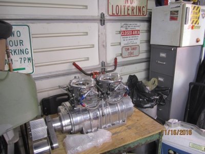

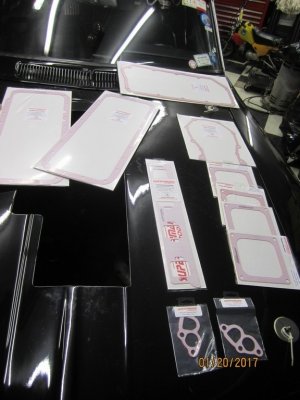

I caught it in time and didn't hurt the bore.So a new set of Diamond pistons were ordered.King bearings and total seal rings with SUPERPERFORMANCE gaskets are delivered and waiting.Todd at Marsh Performance http://www.mopartsracing.com/tmc/ is my new GO TO guy for all MOPAR needs.Great guy and normally answers the phone himself.:thumbsup:
The pistons that came out were supposed to be 8.5:1,,,but measured up to 7.44:1 which explains how I was able to run 13 lbs of boost on pump junk.The camshaft was installed 6* advanced.:(
The new pistons will be a true 9:1 with the cam installed straight up like it should.This will also limit the street tune to 3 or 4 lbs of boost on the pump.

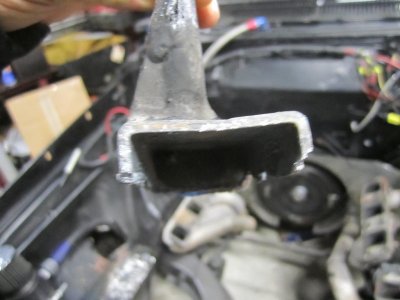

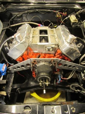

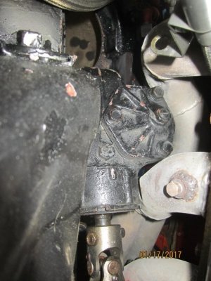

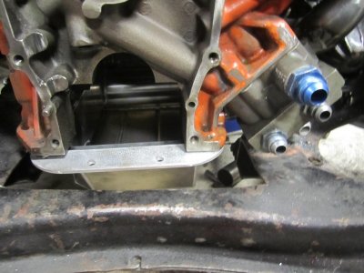

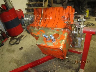

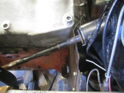

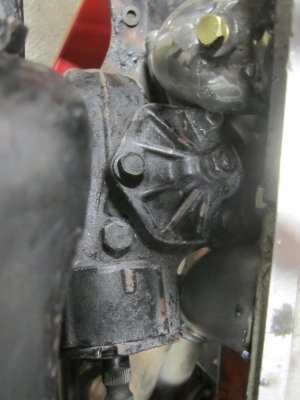

That 35 year old milodon pan when I 1st installed it the centerlink hit at full turn.so as you can see in the earlier pic I took a 1 inch tall piece "c" channel was stuffed under the engine plate and that did the trick for over 18 years.But THAT is about to change!

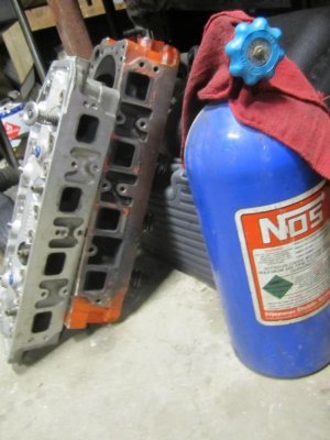

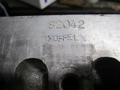

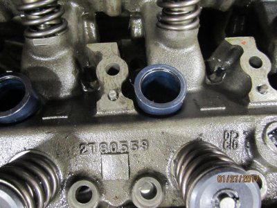

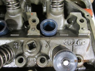

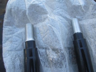

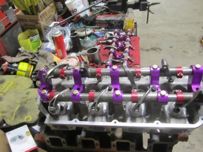

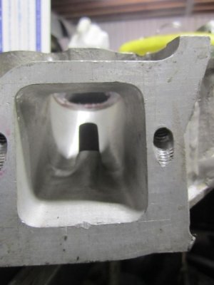

Enter a set of Direct Connection Dart dual plug aluminum heads that were modified by Total Flow products in Michigan.After speaking with Steve Sanchez who remembered these heads that were sent to him by Koffels Place in Ohio.
Steve said I'm gunna LOVE these fueler heads!!:thankyou:

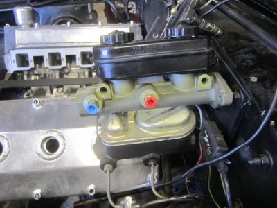

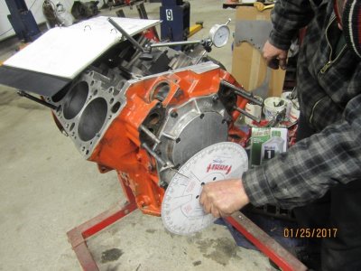

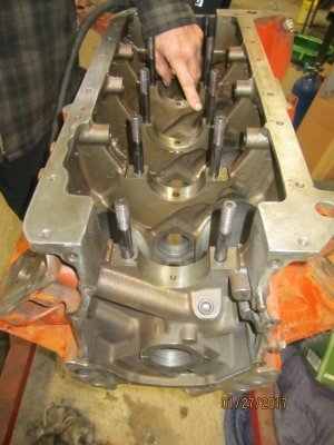

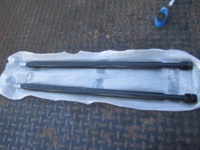

And my freind Freddy gave me a master,just have to check the boresize.Hope to be back together in a month or so! Also received a pair of aluminum strut bars and the parts are rolling in!

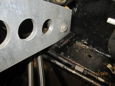

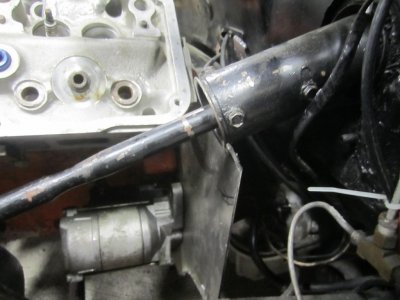

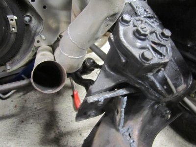

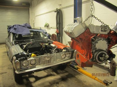

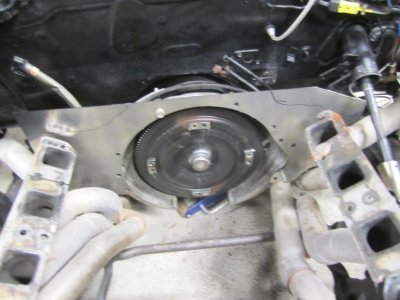

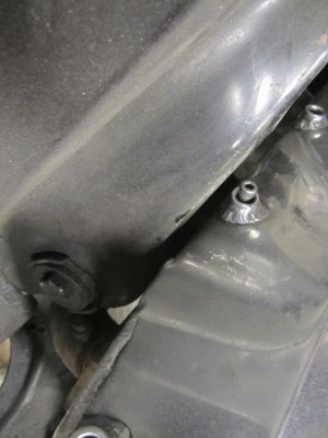

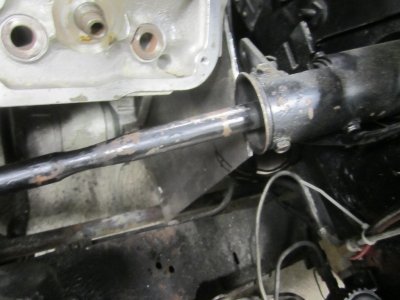

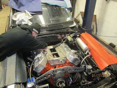

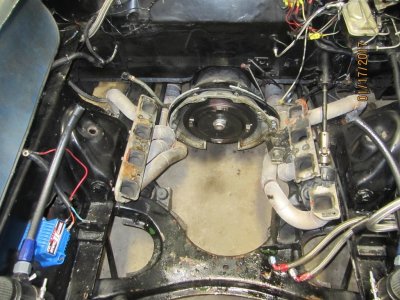

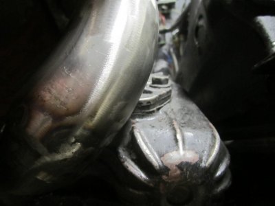

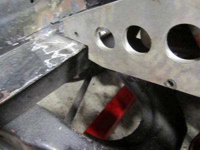

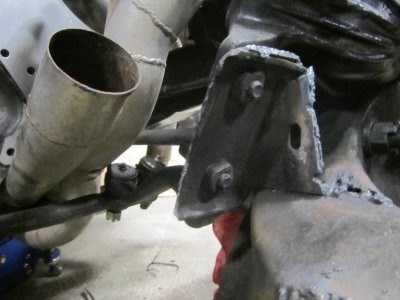

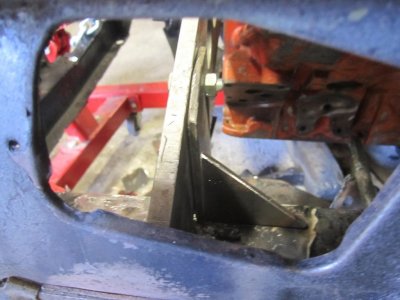

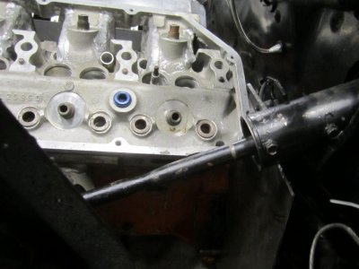

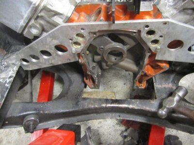

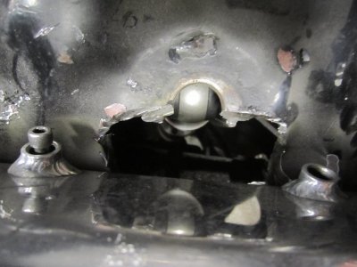

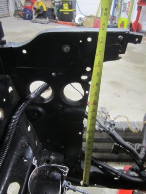

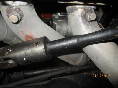

Also dropped the nose of the engine down from 8* down to 3*Nothched the "K" so any style pan will fit with access to all pan bolts.After dropping the block,that created 3 inches behind the r/s valve cover so we set the engine back a little over 2 inches.The only header tubes that were effected are the 2 by the starter.Above you can see how the bottom of the steering column was chopped off,I was supposed to and pull the column and gut all the 3 on the tree innards but was just too busy so it was chopped.When I get to pull it,,,,will gut it and pretty it up a little.

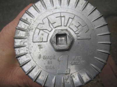

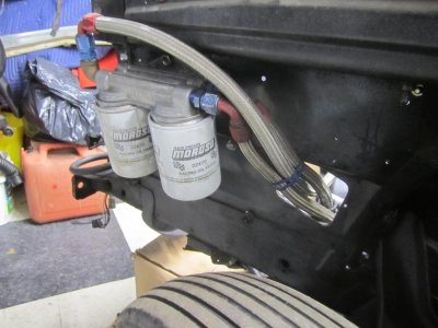

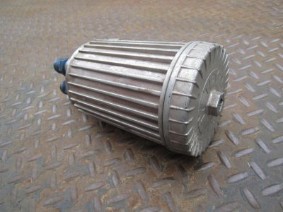

The dual oil filter set up will also get eliminated and replaced with a System one canister.

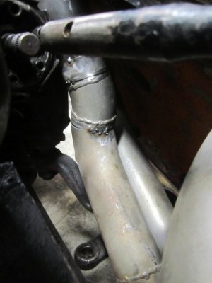

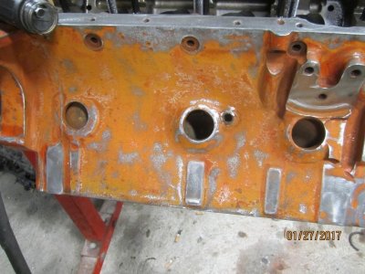

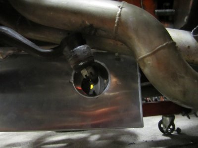

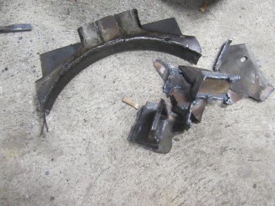

Header tubes finally done,had to wait for tube to come in,Trans mount reconfigured and raised the tail up a tad.I dropped the heads off at the welder to close the o-ring grooves.He will have them done by Wednesday and then they get a few thou milled off.The block might come out today and let the cleaning begin for assembly of the shortblock.When the block comes out,the "k" will be boxed and the tabs for the mid plate and engine plate will be finish welded.THEN,,I can degrease the engine compartment,prep and paint.
