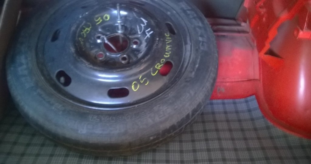

Space Saver Spare for 66-70 B
SlinktRR
3:56 AM
Aug 27, 2012
1,424
860
Dallas TX
I found that a lot of late model Fords carry the 5x4.5" bolt pattern, including the 2005 crown vic which I got this donut from at the salvage yard. Explorers, Escapes, Edges and Broncos also have this pattern just have to be aware of the offset. 16 and 17" Ford OE steel wheels also bolt up from these models. This one is 27.4" tall.
