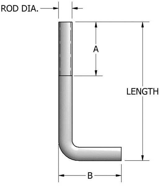

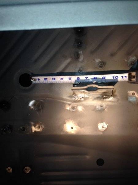

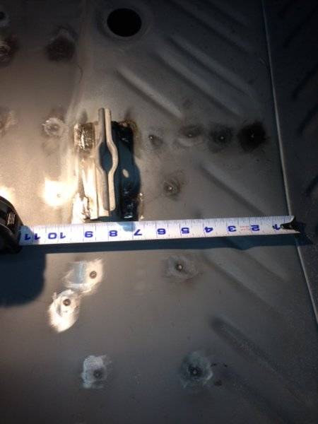

I made it out of threaded rod stock, bending it to a J hook and found a large wing nut at the hardware store.
Spare Tire Stud
I have a 14' spare size
Threaded stud rod stock cut to size.
.11' to bolt hold down hole.
.3' "J" length .
.4 1/2 thread length
