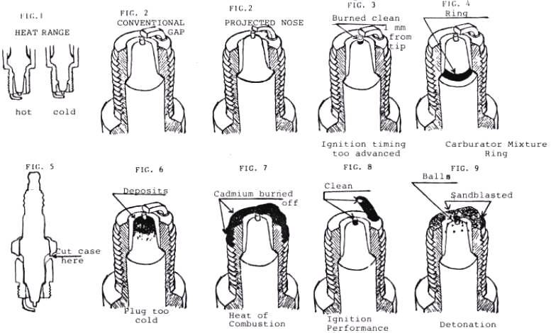

Not really....the heat range of the spark plug relates to the plugs ability to transfer the heat generated in the combustion chamber at the center electrode to the cooling system via the plug's insulator and shell. A hot plug has a longer center insulator, allowing the heat generated to travel farther, b4 bring absorbed by the cooling system. Conversely, a colder plug has a shorter insulator which absorbs heat faster allowing the center electrode to operate cooler.
IF a higher heat range (hotter plug) is used in an engine designed to operate with a cooler plug (low heat range), two things MAY occur. The center electrode would melt or the piston top may be damaged or possibly both. A hot plug may inniate pre-ignition or more likely detonation. While a cold running plug will NOT prevent detonation. A cold plug will, in all likelihood, become fouled resulting in a mis-fire resulting in a lack of power.
Not all spark plug manufacturers use the same heat range scale or criteria....Champion differs from NGK from Bosch, from AC, from Autolite or E3. You must do your own do dilligance for what ever brand you select to see where your choice of plug falls within the manufacturers heat range scale for your operating condition and engine. Under certain conditions (in a 1/4 mile contest with open headders) you will be hard pressed to actually hear the detonation, should it be occuring.
