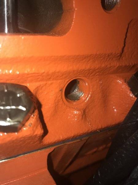

If you have heads with taypered plugs there isn't a gasket. The plug hole in the head has a taper to match the plug. You won't get a plug with a gasket/ring to go all the way in.
Heads that take the plug with the ring on it has a flat seat in the plug hole.

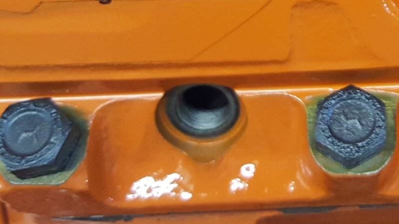

These are the 452 passenger car heads. Plugs with a ring or crush gasket. See the recess...
This head takes the taypered plug without a gasket/ring.
