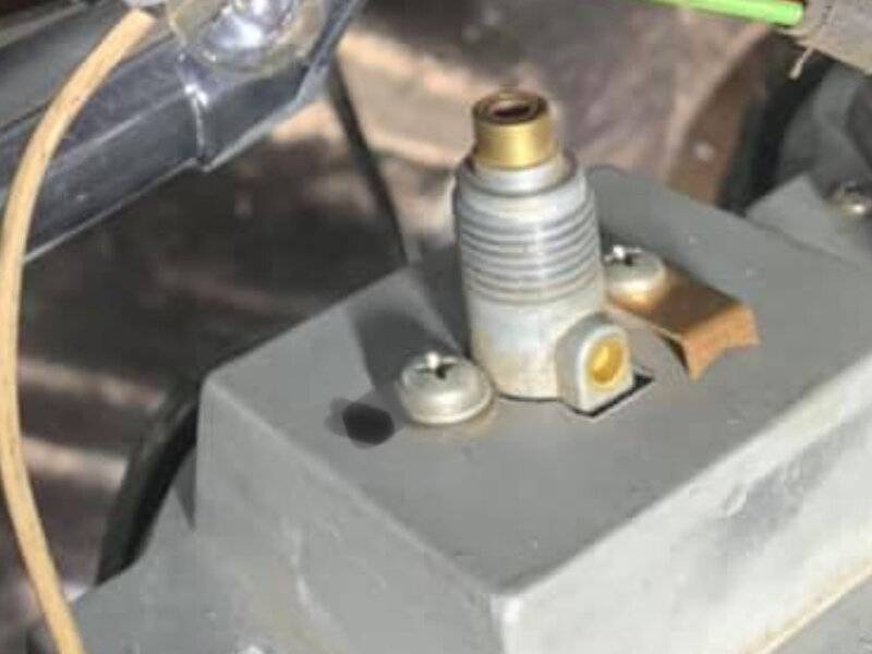

some have this oil port on the back. I don’t think a 68-70 rally has this.

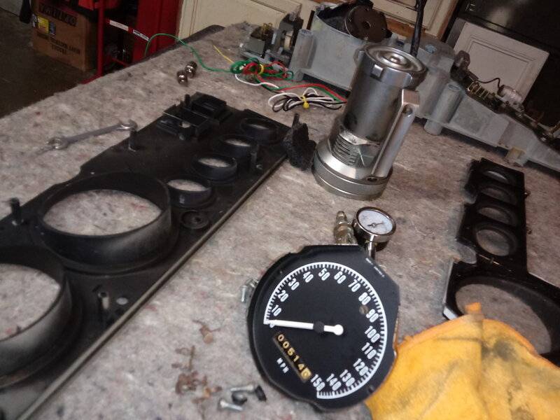

I don't really care about a correct reading, yet, thanks anyway. I have a 3.91 rear end gear so the speedo is going to be off. I'll change the speedo gear for that later.... I got the cluster out and all apart, and freed/lubed up the speedo, I also reset the odometer to about how many miles I have on it. Don't tell anyone, ha. That odometer was like figuring out a Rubik's Cube, shezz!.. Now to get it all back together,, tomorrow, yawn!.. I'll report the results..

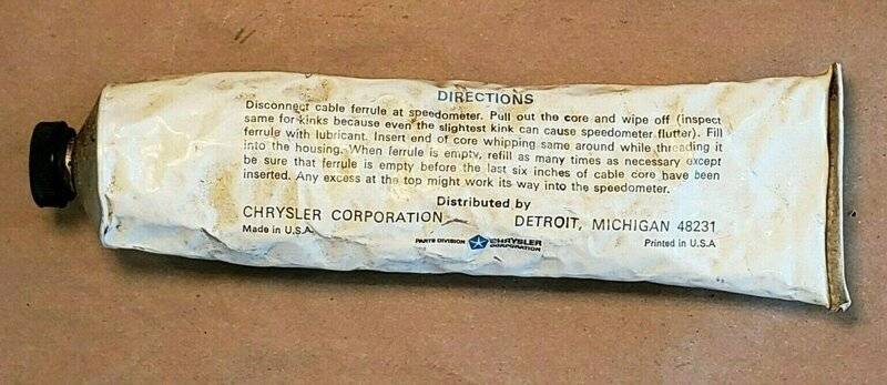

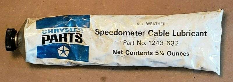

Here is factory speeedo cable lube with instructions.
I’d say the cleaning step is very important after 50 years of use. I pull out the core and wipe it with a lint free cloth and Brake cleaner. Put in in and take it out and repeat until the rag stays pretty clean. Then apply lube. I’ve been using wheel bearing grease in a tube, it’s not overly thick. Valvoline #615 dark red.
