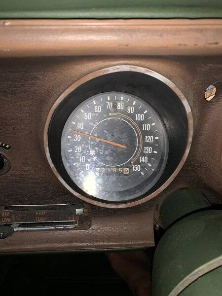

Quick fix for a Speedo that’s pegged at 35 mph like in the photo?
Probably the Speedo, might be the cable. Take it loose from the tranny and see what you can see. Most speedos turn counter clockwise, but go slow and be gentle. Speedos are fragile.
If the odometer is working correctly its in the drive for the needle. Head time.
