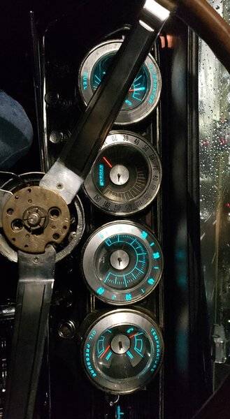

Most of my gauge lights work. Seems as though the tachometer arm doesn't light up anymore. But the speedometer dials and arm will light up (the most I've had it work is like 5 seconds) then will die. Like once a week it will light up. What should I look to correct first?

These are electroluminescent strips no bulbs. Since the others work your power supply is working.
Likely a bad solder joint or trace on the board or the strip has a bad spot.
You would need to pull the cluster to sort that out.
