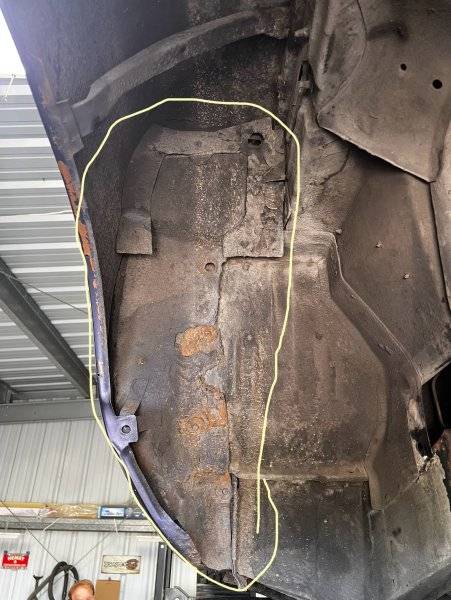

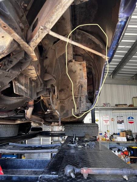

Hi everyone I don’t know what this is called but does anyone have one and the bolts? It’s for the drivers side as in the pics the passenger side has it it’s a 1969 dodge coronet
It would definitely help if you mentioned what model and year it was for. They're called splash shields also...
Look for an original set if you can. There are aftermarket replacements, but it takes some work to fit them. Carlisle is next Month...
I just replaced those on my '70 Charger:
See post #98
Make sure you buy the vertical rubber pieces and fasteners as they're not included with the splash shields. I had some trouble removing the rusty original fasteners as the bolt heads are very shallow and at risk of being stripped out. I found that pounding around them with a hammer helped loosen them up.
I didn't have much trouble with the fitment, but I did find the little metal clips did a piss-poor job of attaching the U-shaped rubber gaskets. The holes in the metal splash shields were a tad too big and the clips barely held them on. I had some spare plastic body clips that fit much more securely and IMO looked better, too.
