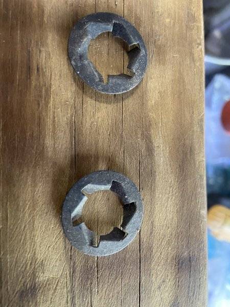

Hi Team,
Thanks for all the help thus far. I’m having a really hard time finding a new one of these. Any direction you could point me towards? Thanks again!
Ace Hardware sells them
If you can’t find them give me a shout and I’ll buy 2 and send you a pair. Their cheap and don’t mind sending you a pair
