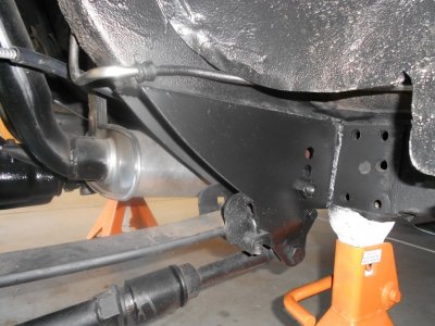

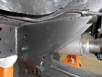

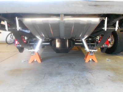

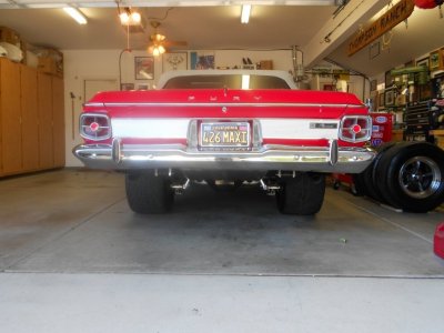

New rear end 002.JPG New rear end 004.JPG New rear end 007.JPG New rear end 011.JPG

Is your Plymouth mini tubed also?
Dave ^^^^^^
Is your Plymouth mini tubed also?[/QU
Yes, the inner fender wells were moved inboard to the frame rails. Using Billet Specialties 15"X12" (5.5"BS) Street Lite wheels with M/T 29"X15.0R15" Sportsman S/R tires.

View attachment 367351 View attachment 367353 View attachment 367355 View attachment 367356
