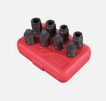

Use a square drive socket or an 8 point if that's all you can find. Hit the plug with a small hammer to help upset the threads.This is what is being removed.

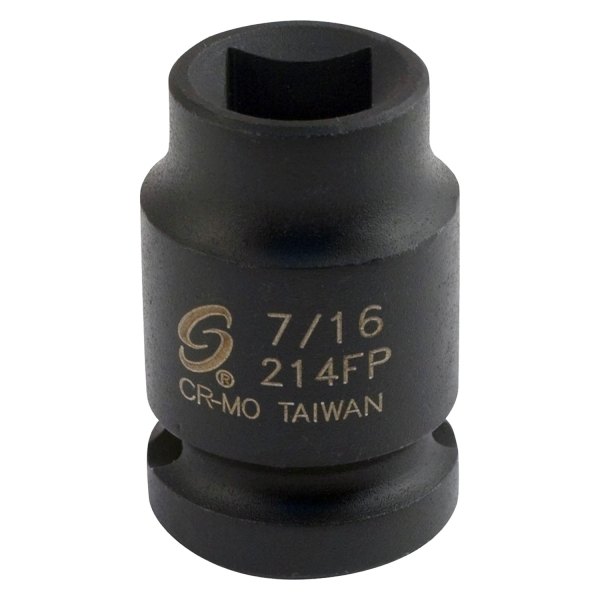

This is spot-on. They're actually sold as 10mm drain plug sockets. Common on foreign cars. How they ended up in your block is another question entirely. But that's what you have. I just measured a couple 10mm open-end wrenches and got .401 - .403 across the flats, the socket should be similar.how about a metric 4 point socket....10mm would be close 10.16 =.40 https://www.amazon.com/HARFINGTON-B...chanical-Maintenance/dp/B0DQH27PCJ?gQT=1&th=1

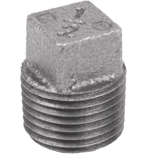

.400 measured at the top of the square or the bottom. They have a slight taper and a 1/4" square plug isn't exactly .250.After 50 years, I can't take it anymore. I have to find the proper tool to remove these plugs. These plugs are square head .400" across. Yes, I can find square sockets. But not .400" across. Is there a Chrysler special tool for this? I can't fight this anymore. These blocks are over 50 years old and the plugs are stubborn. Yes, I can weld a nut on them and they've never failed to come out but I'd rather not have to do it that way. I have to find the proper tool to remove these plugs. Help me Obi-Wan Kenobe you're my only hope.

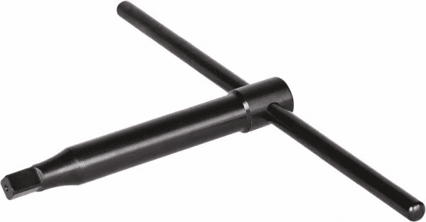

check these out: https://www.amazon.com/dp/B09F64XLC...3df11e5953&sp_csd=d2lkZ2V0TmFtZT1zcF9kZXRhaWwAfter 50 years, I can't take it anymore. I have to find the proper tool to remove these plugs. These plugs are square head .400" across. Yes, I can find square sockets. But not .400" across. Is there a Chrysler special tool for this? I can't fight this anymore. These blocks are over 50 years old and the plugs are stubborn. Yes, I can weld a nut on them and they've never failed to come out but I'd rather not have to do it that way. I have to find the proper tool to remove these plugs. Help me Obi-Wan Kenobe you're my only hope.
Oops! Disregard my response. I thought it was for female square plugs.This is what is being removed.
