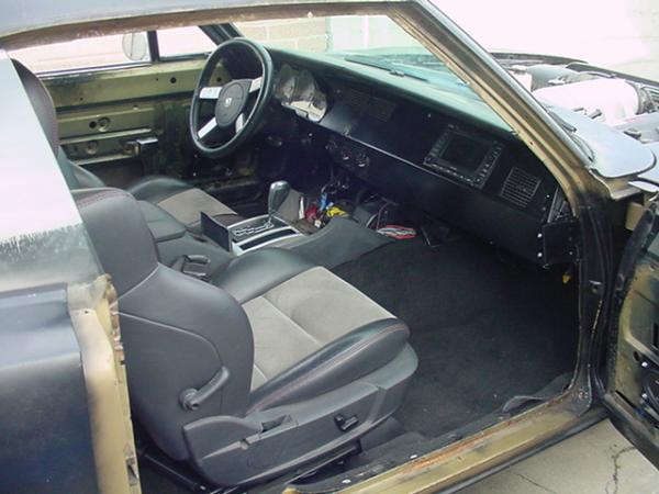

put a 05 magnum srt8 complete chassis under a 68 charger shell...
Now that is what I'm talking about. This deserves an entire thread! You plopped the Charger body on an LX Chassis? Wowsers, that is what I want to see, you got my gears spinning!
Wow! If this is your car, and your build then sir, my hat is off to you, and your skills in making this car a reality! You have certainly set the bar higher! Is this something your configured in your head? What are you using for the VIN, the Charger, or LX car? I thought I was insane in metal work! You are giving me some new ideas!!!!!!
