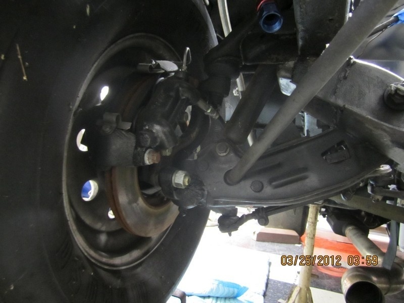

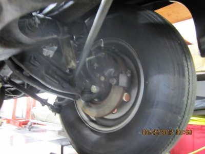

I did both the front & rears with a SSBC set up on my 66-300. This allowed me to keep my spinners that I had/have on it. For whatever reason and even SSBC couldn't answer was that I needed 5/8" spacers so they wouldn't rub the rim, go fig? If anything, I would upgrade to better pads but I've been happy with it for the last 10+ years now.
I forgot, I had 11 X 3" in front and 11 X 2-1/2" in the rear.

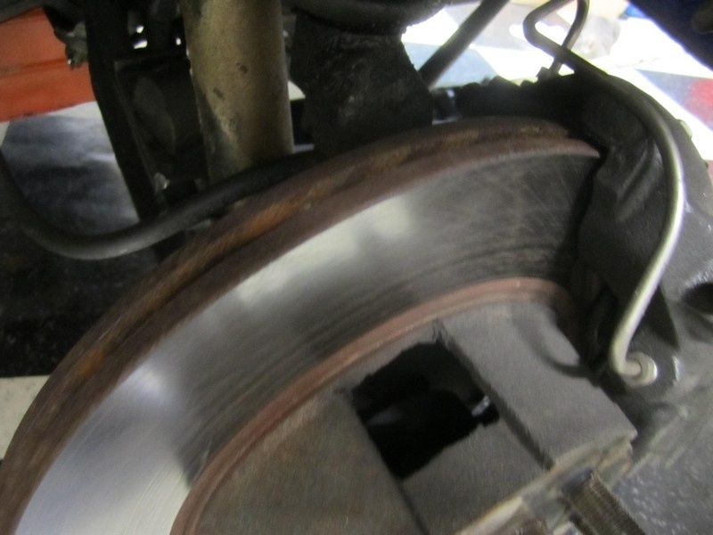

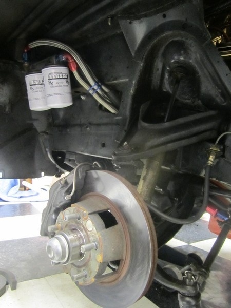

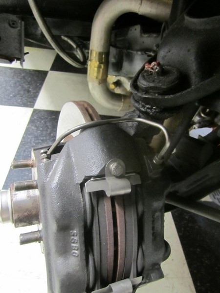

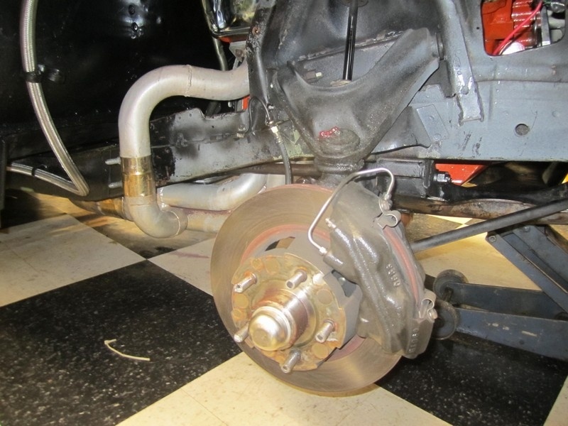

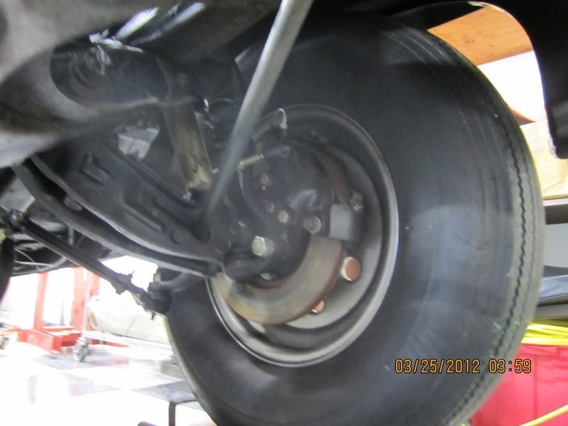

I bought and installed their kit.Everything was there right down to the cotter pins.I did not get the fancy rotors and my 3900 lb car stops great from 145 MPH.Should go 150+ this season!
3.25.12 (4).jpg 3.25.12 (5).jpg 6.16.13 006.jpg 6.16.13 007.jpg 6.16.13 008.jpg 6.16.13 009.jpg
