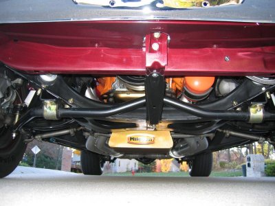

This one is from Firm Feel--and what a positive difference it made; outstanding!
You will be glad you did, and will be even happier if you put in a smaller rear bar too.
