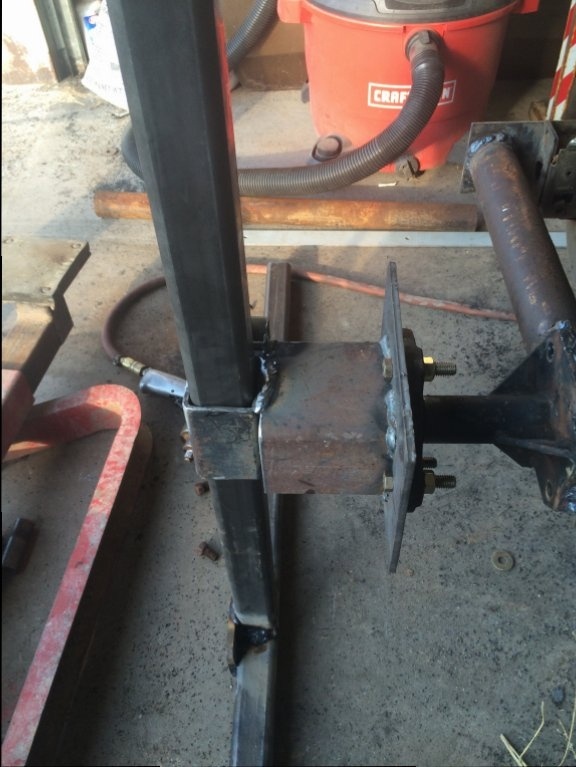

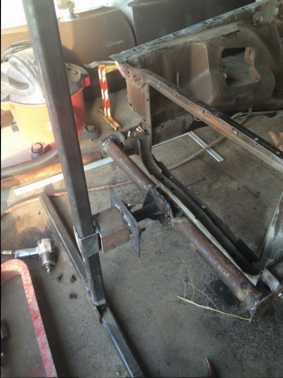

Started building my rotisserie today

I was thinking of building one. I have seen these sell without jacks $850 and up, with jacks $985 and up. Would you be willing to share your plans for raising and lowering the car? I to will be looking forward to seeing more. Thanks
Wish mine wasn't loaned out or I'd share pics of how I built mine. The biggest thing is building a lot of adjustment into them having box tubing that will slide over another box. The problem is the internal welds in the box, we built a cutter that you could press threw the tube that cut the weld out. Once you have one you'll never go back.
