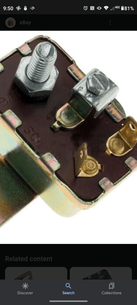

Start with something simple. Stick a screw driver between the starter relay studs and see if it cranks.

No where did I say pull the starter. I said jump the starter solenoid studs (at the firewall). Make sure it's in park and stick a screw driver between the battery power stud and the small wire to the starter itself. It should crank or at least click the starter bendix solenoid at least if the battery is low.

Jump the stud that comes from the battery to the wire the heads down to the starter.
