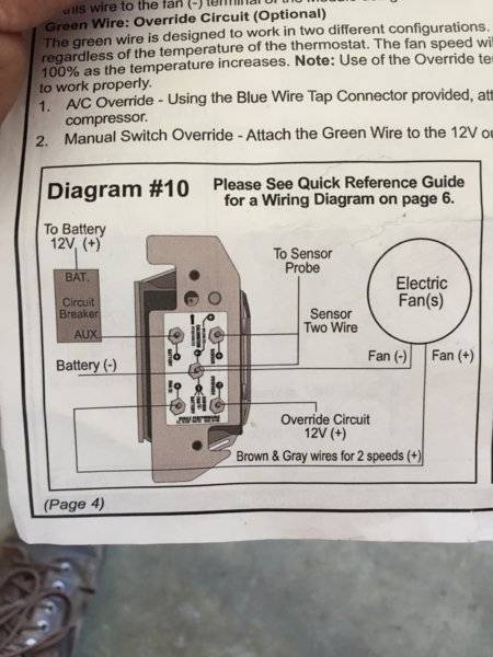

1 power, 1 ground. Here’s a pic of what it looks like.
Yep, that’s all she wrote.
If I’m right, that override is optional to be wired to a toggle, which when on will override the controller to turn the fans ON, not off. Id guess the people posting about the fans coming on with the car off are referring to that. They’d run slower of course because they’re only at 12v vs the 14-14.5 they’d see while running.
