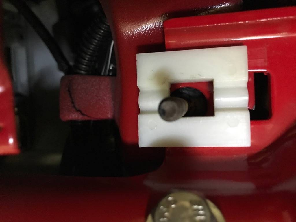

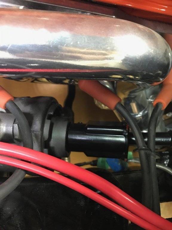

Im Installing The Steering Column In My 68 Charger and Was Wondering a Few Things..
Is The Steering Coupler To The Power Steering Pump Supposed To Be Bottomed Out Like That?
Pic Enclosed..
What Holds The Column From Pulling Into The Drivers Compartment Or Sliding Back and Forth If The Plastic Tabs Fail?
Where Are The Studs Supposed To Line Up On The Column Bracket? The Pic I Enclosed Is With The Steering Assembley Pushed All The Way Forward.. Supposed To Be Centered?
Dont Wanna Push On The Column and have It Slide Forward..
