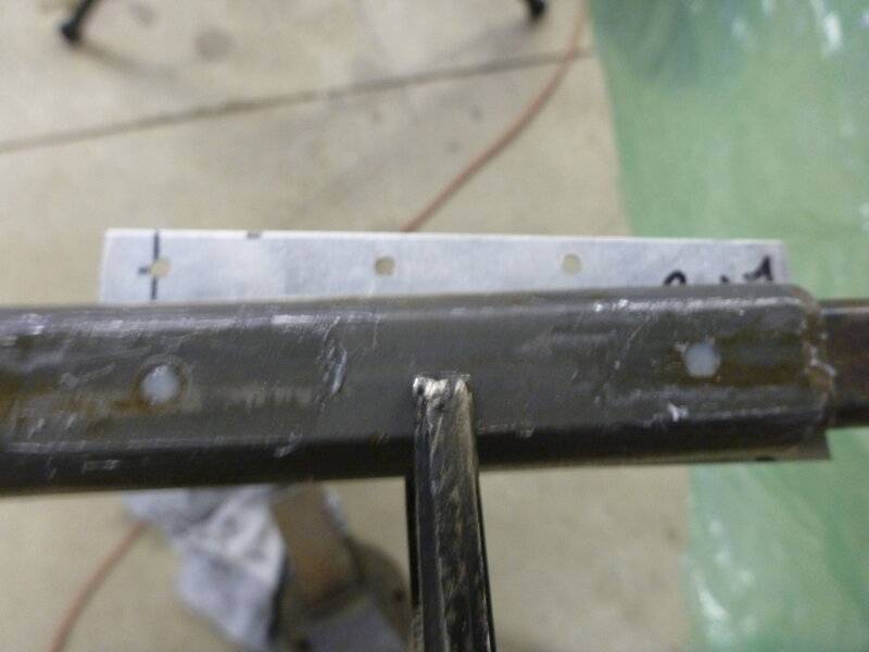

Did you happen to drop it shaft down onto the floor and collapse the inner two piece shaft? Even if you didn't most find the plastic shear pins gone after 50 years of people beating on the steering wheel.

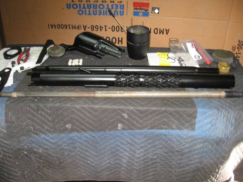

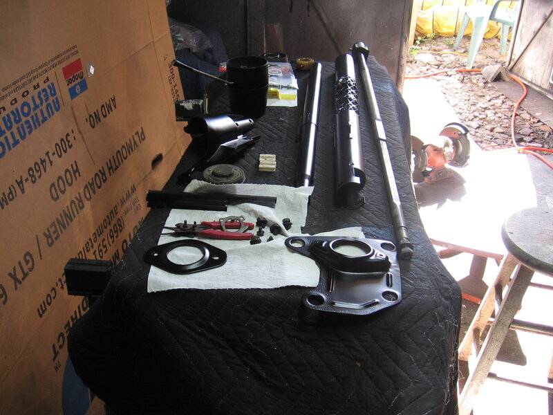

Yes they do make that part. But if you put it together the end cap tab's bend over to hole it together. I did not get that part. My shaft had some play in it when installing the column. It will slide a little. Where the retainer spring is that is where the bearing went in to the column Dose it not seem to line up with your bolts under dash. Their is a U tube video on rebuilding these. It is help full. Don't forget about the two bolts on both sides that hold the upper column cover under steering wheel. I had an awful time with them. In the second picture you see the spring that could be holing you from extending the tube. It is strong. Takes force to move them. Good luck you will figure it out I am sure.

I recognize many of the pieces you are showing however I have not taken the column apart far enough to get to the 'spring' you mention / show. Is it located in the upper half of the column??
Is it very difficult; i.e. do I need a press to put a replacement bearing back in or use a puller to disassemble the column??

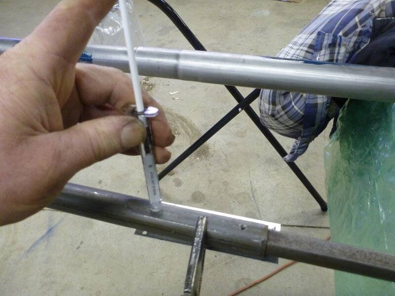

View attachment 1173705 View attachment 1173706 View attachment 1173707
I notice that this 'joint' where the plastic pins are is part way along the main shaft of the steering column. Is the joint in the upper half of the column? Are specialty tools required to remove and reinstall the bearings and if you are going to recreate the plastic pins would it be advisable to replace all the bearings too??

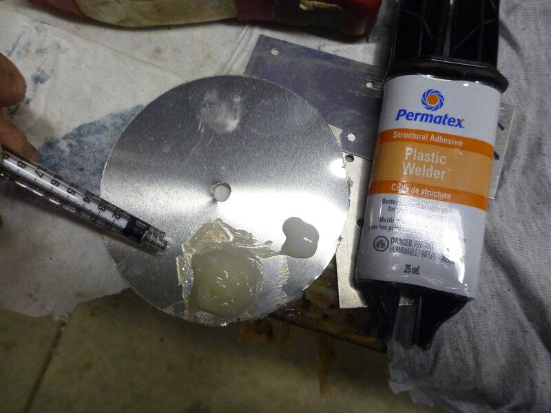

I did 'in my travels' come across a b-body link which indicated that if the plastic pins have deteriorated and the steering column has collapsed that you can "reinstall" the pins using "Pematex" plastic welder and a syringe.

What comment would you like, that's my post! :)
Bearing puller for the top bearing. Bottom bearing is a plastic bushing. Been a while since I did mine. Like I said their are U tube video's on the process. Plus manuals are around. Check the forum dadsbee posted also. It is not that hard. One thing to do is take pictures and more pictures it help's. Love Chiltons manuals it say reassemble as disassemble.

Rebuilding my steering column now, and found the pins sheared. Unlike Dadsbee, my St Louis built 69 did not have 'through pins" in the steering shaft. Instead the inner shaft has upper and lower grooves around it that line up with the pin holes. The hot melt was poured in and surrounded the shaft filling the in/out holes holding the shaft in place......at least for a while.
Different parts suppliers I guess, I've seen that on a '69 Barracuda column that was being restored as well.
