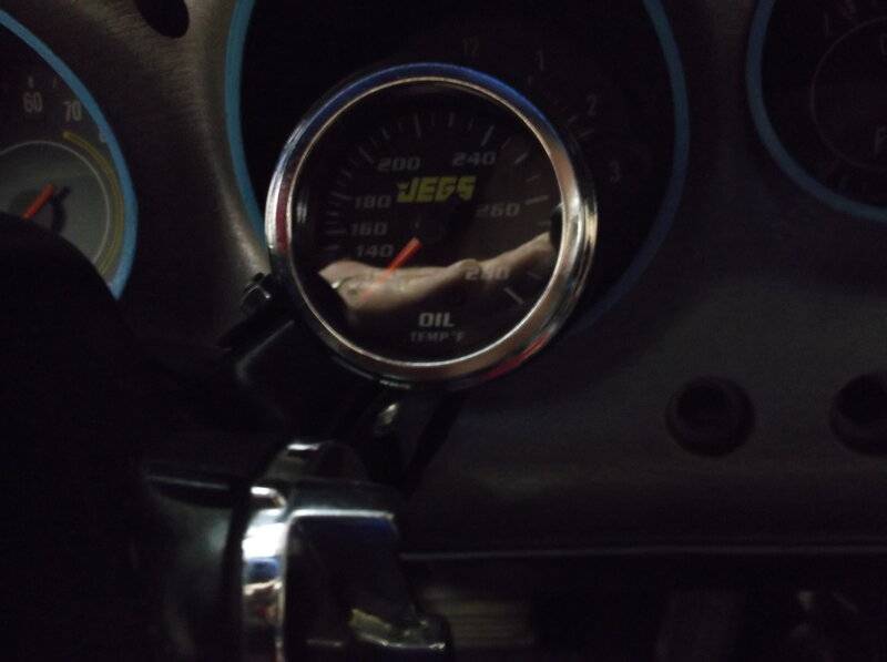

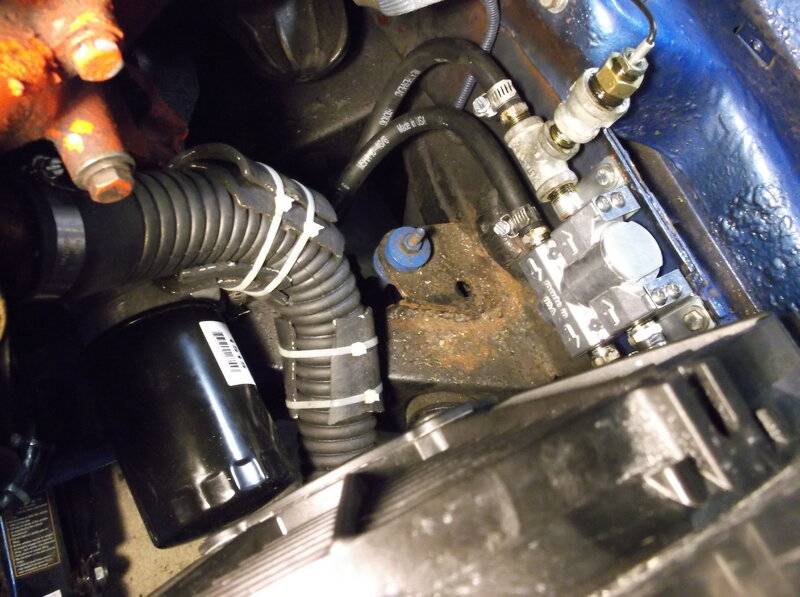

My car was a column auto, converted to floor. The stick was removed, but because I'm a lazy cheap bastard, I mounted an oil temp gauge where the column shifter used to be. I put a hefty spring off of the lever on the lower column to the frame so I can move the gauge some if I need to. I have a lousy picture of it :::::::::::It really works, not just a phony!

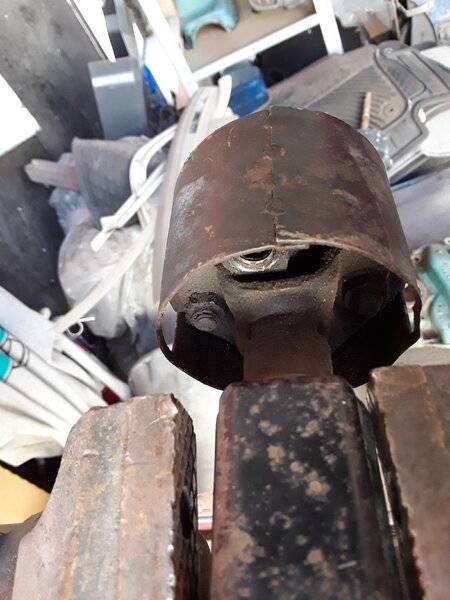

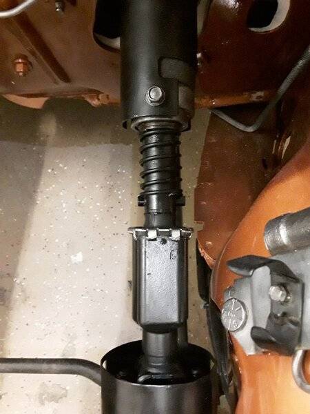

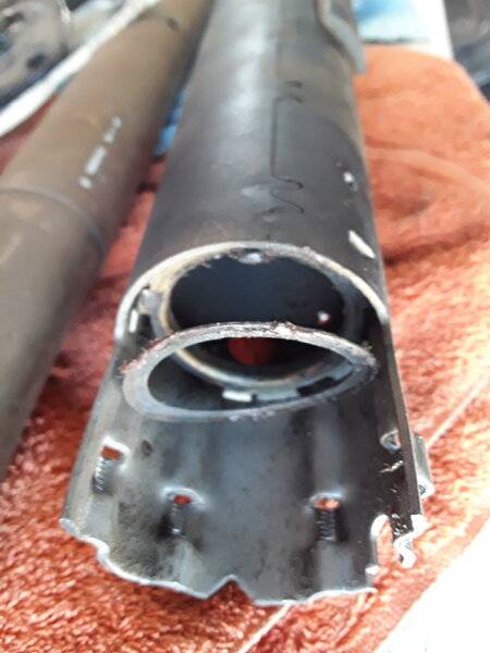

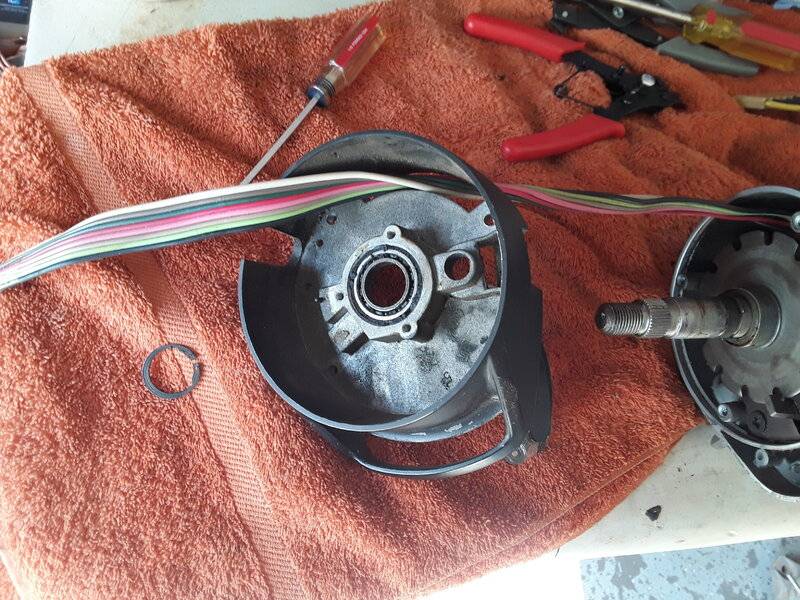

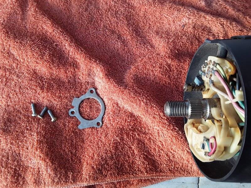

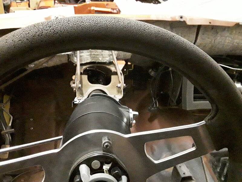

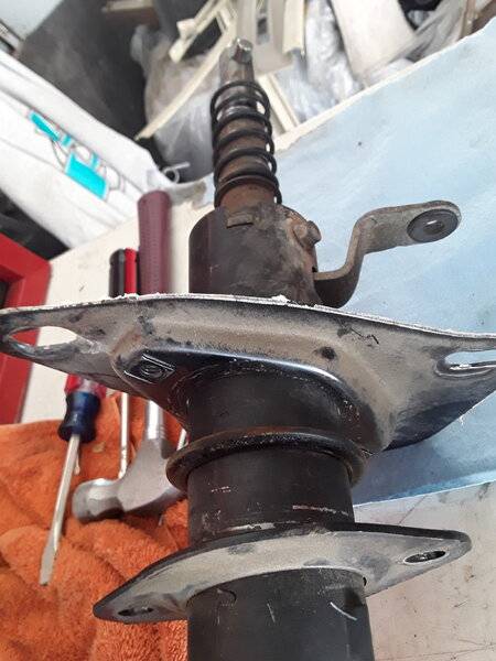

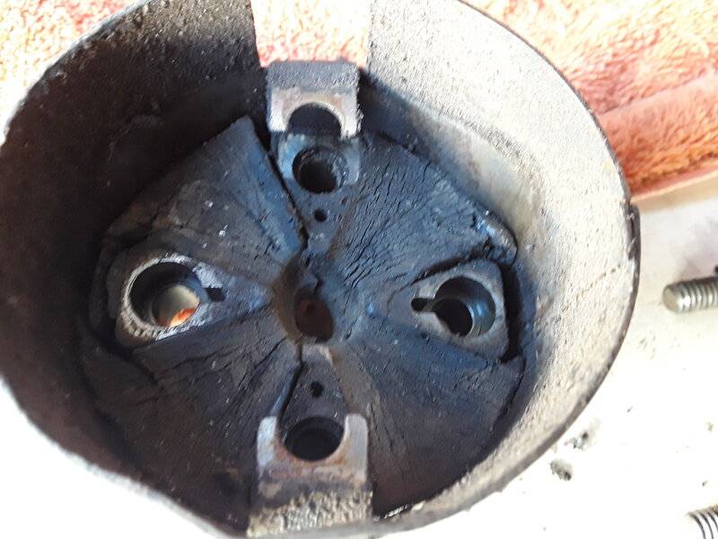

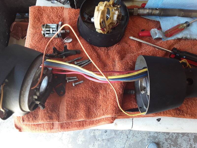

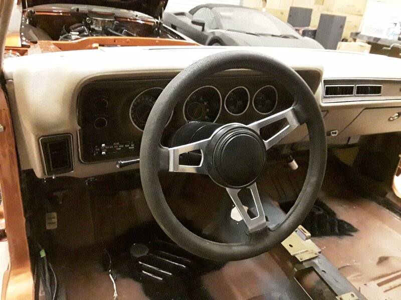

Use a donor column for the clar. I had to source a swing for the collar as my doner column did not have one. Only the lock collar needed to be replace but you do have to remove the shift tub and not put it back in. The body manual said not to put the shift tube spring washer back in but I did not like the play so I took it back apart and put it in. Much better fit. Here are before and after pics.
I just complete the same swap. I rebuilt it from scratch rag joint to turn signal switch. I h
Use a donor column for the clar. I had to source a swing for the collar as my doner column did not have one. Only the lock collar needed to be replace but you do have to remove the shift tub and not put it back in. The body manual said not to put the shift tube spring washer back in but I did not like the play so I took it back apart and put it in. Much better fit. Here are before and after pics.View attachment 1065625 View attachment 1065626 View attachment 1065627 View attachment 1065628 View attachment 1065629

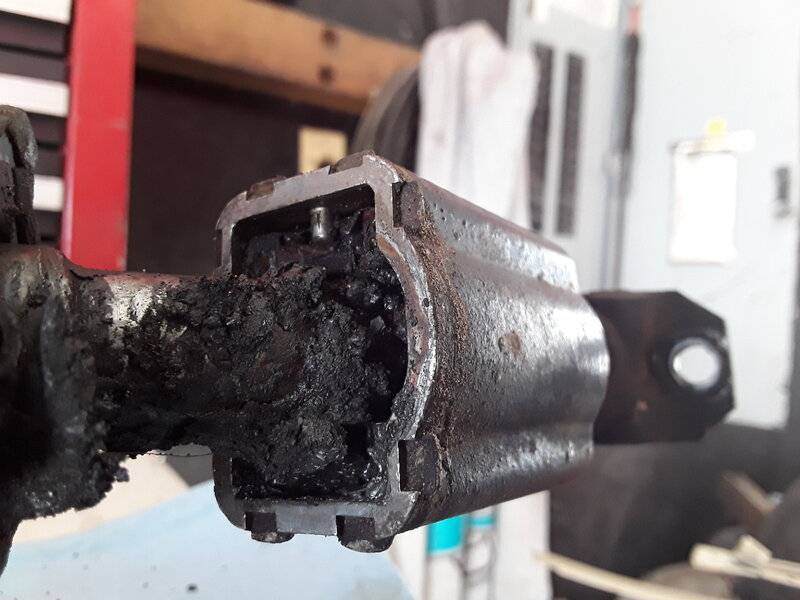

I' have allways thought there is more involved to get the full conversion, like remove the linkage tube should make change on the lower bearing. But for the cabin transformation, already explained what is involved.

You are correct to make the engine compartment side look correct you have to remove the linkage tube and replace the bearing. I wanted it to look factory so I chose to do the whole dismantle which was needed anyway to do the coupler and the ragjoint. On the interior side it is only the collar. I bought the donor column a few years ago before the aftermarket replacement collars were available or I might have gone that route.

I drove the pin out with a punch but you have to be careful and go easy, you do not want to damage the collapsible pins in the column
He is another hint, YouTube, there is a 4 part series on dismantling and reassembly on an e body column that is very detailed. I also read through the factory service manual and kept it handy during the rebuild. Search this forum to there are a lot smarter guys then me that can help with there tips.

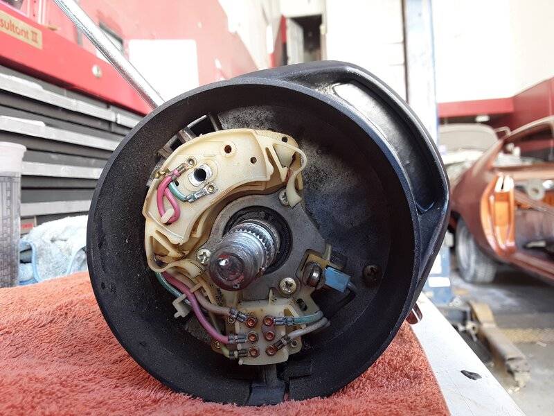

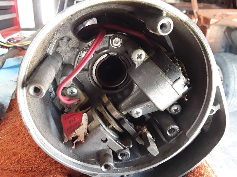

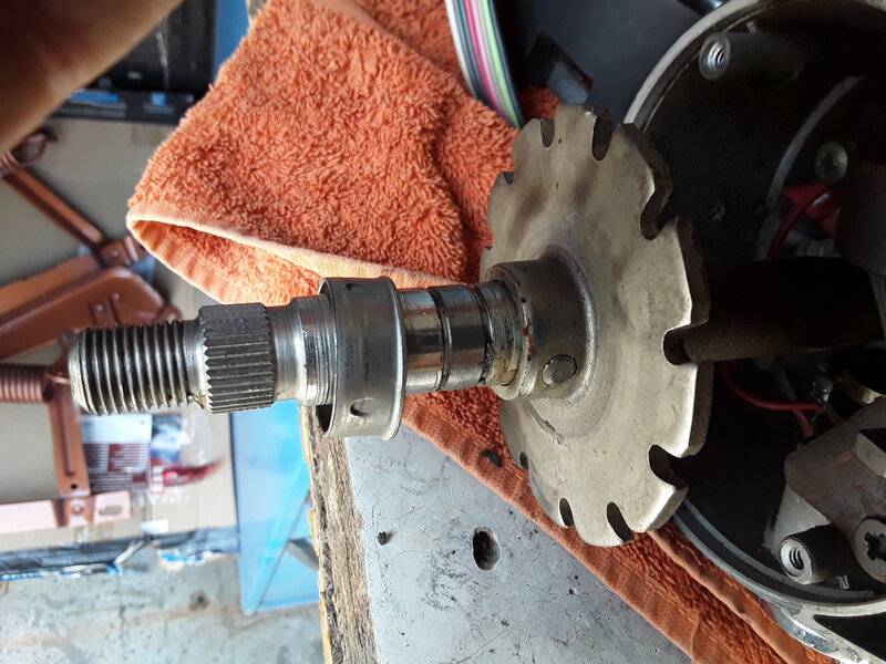

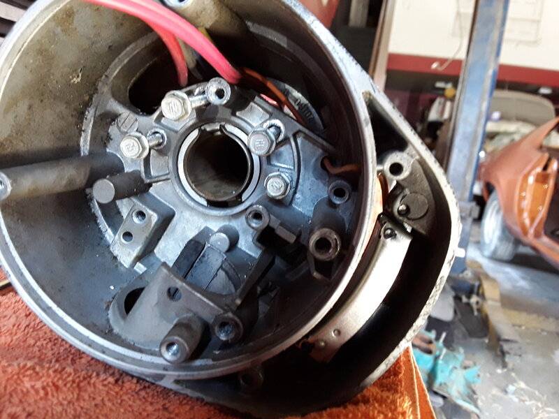

Here are some more pics
My lock collar did not have the hole (bottom center of the pic) drilled for the key cylinder so I had to mark and drill it
This is the wavy washer the manual said was only needed with the shift tube but I put it back in and it tightened up the gap between the lock collar and ignition key collar
