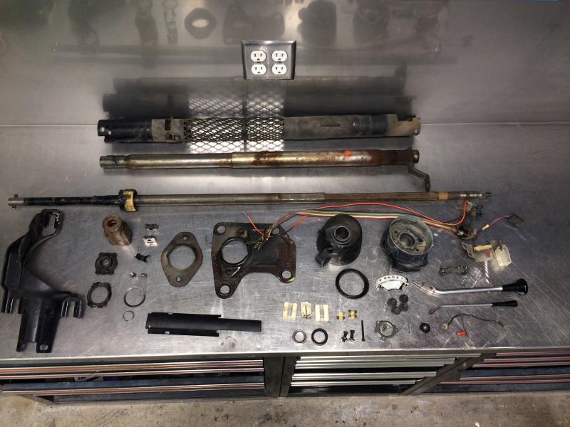

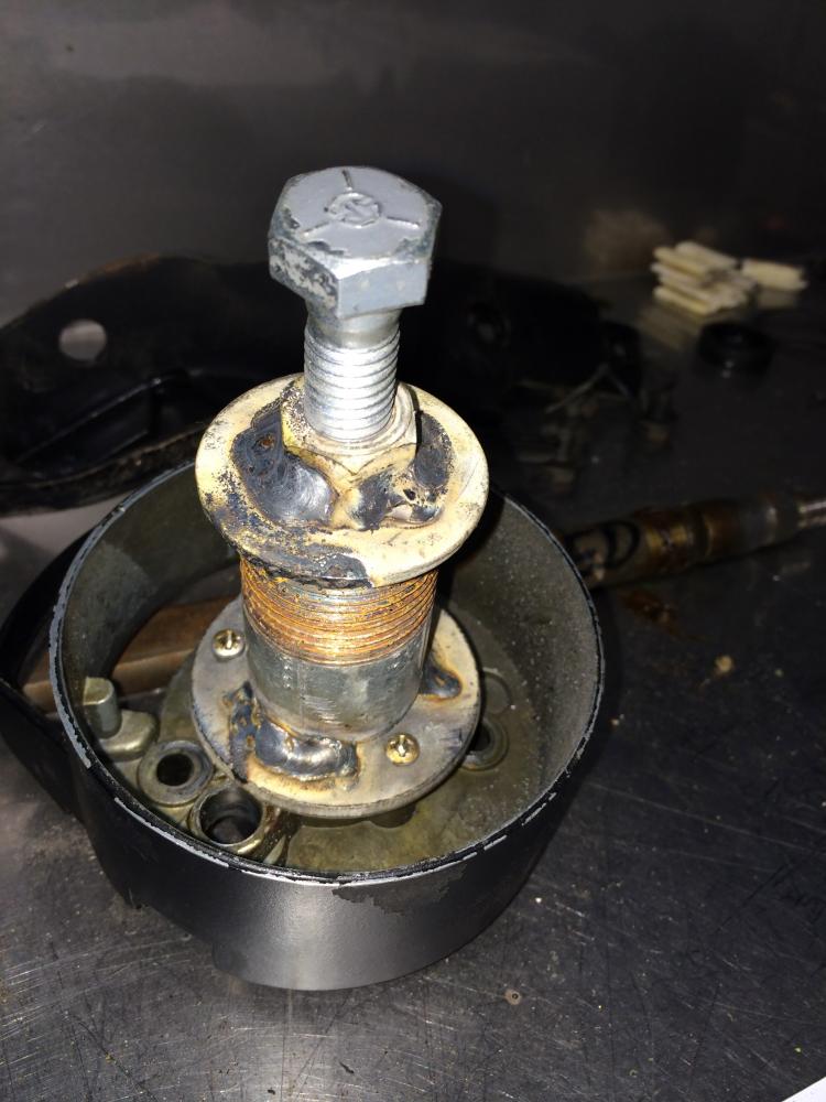

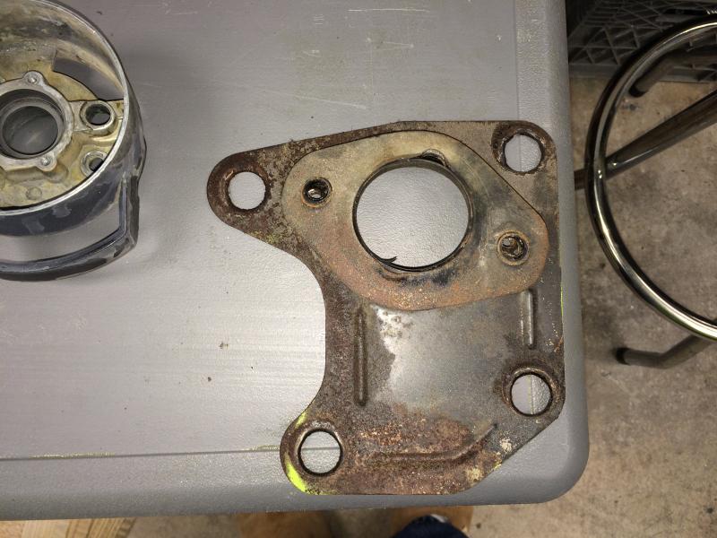

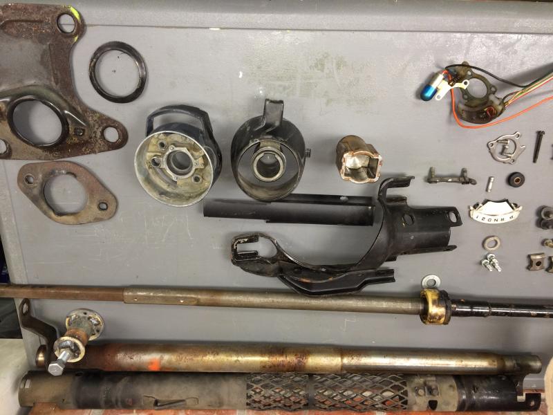

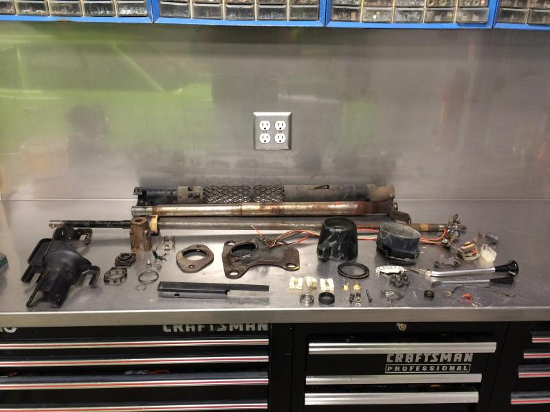

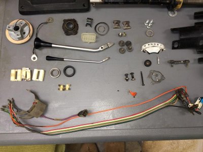

Got the column completely broke down and cleaned of grease. Made a tool to push the shaft out of the column. Better than buying one for 50 bucks !! Ready to blast the parts. Should have time next weekend to sand blast, epoxy prime and paint all parts. I'm going to paint the column with black PPG Suade Duracyl, fire wall plates low gloss black, and column support bracket that holds the column to dash gloss black.
Found a good supply house. http://www.jimsautoparts.com/restoration_parts.htm
They have all the parts you need for rebuild.

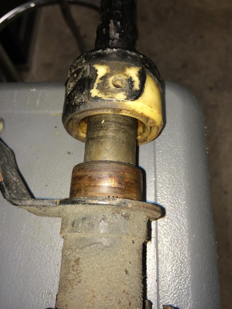

Need help with one thing. how does the lower bearing come off the shaft? Mine won't move. stuck or is there clips/screws holding it on? Manual is silent on how to remove it.

Get a digital camera and take a lot of pictures before, during, and after (so we can drool over it when you're done).

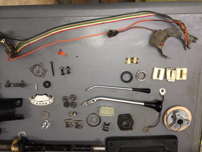

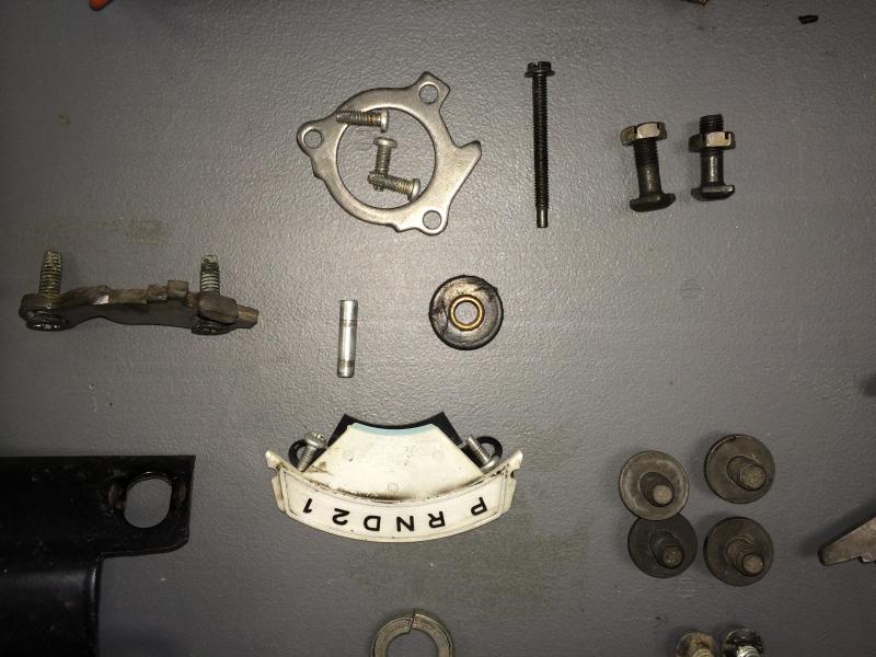

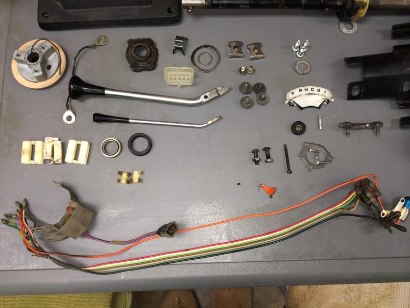

More parts pictures

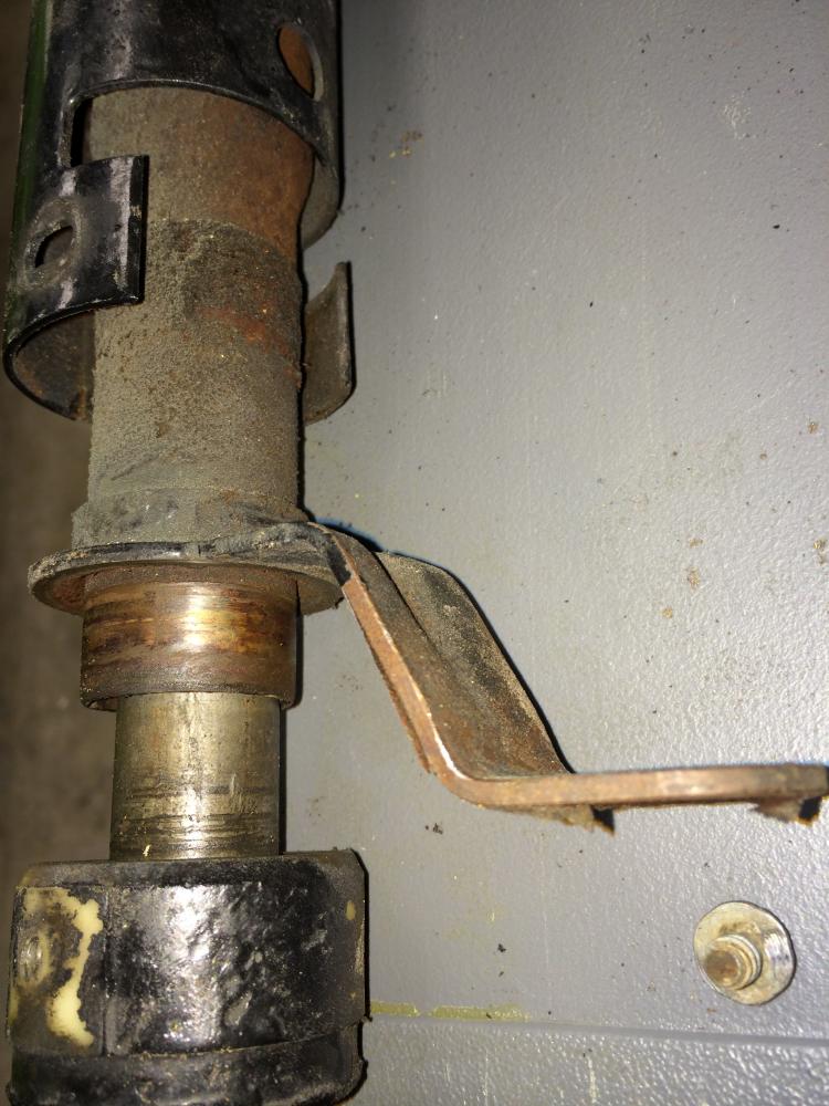

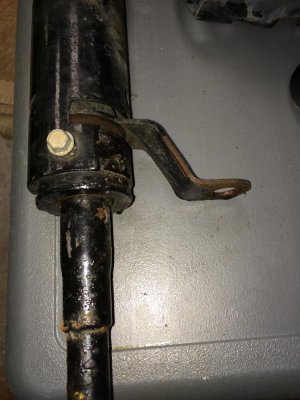

The tube that the shifter is on, does it have a bushing in the bottom of it to make a seal on the shaft. Can you show a picture of the bottom of it where it goes on the bottom? I know a guy you can get that high priced main bushing from a lot cheaper than they are advertised. Thanks Ronnie
Thanks for the help Cudachick !! Much appreciated And your right. Pretty cool color...haha
OKIEMOPAr, I would like to help you but still don't understand the question. Are you talking about lower steering column or uper where the automatic shift arm is to change gears.

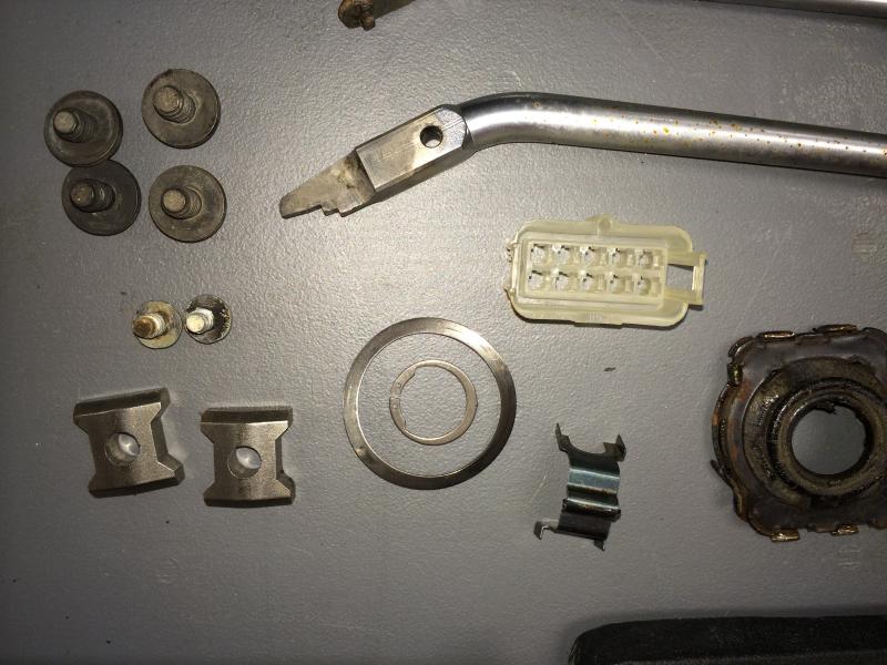

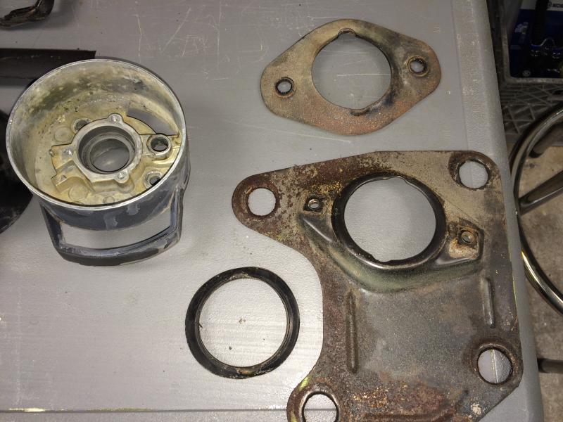

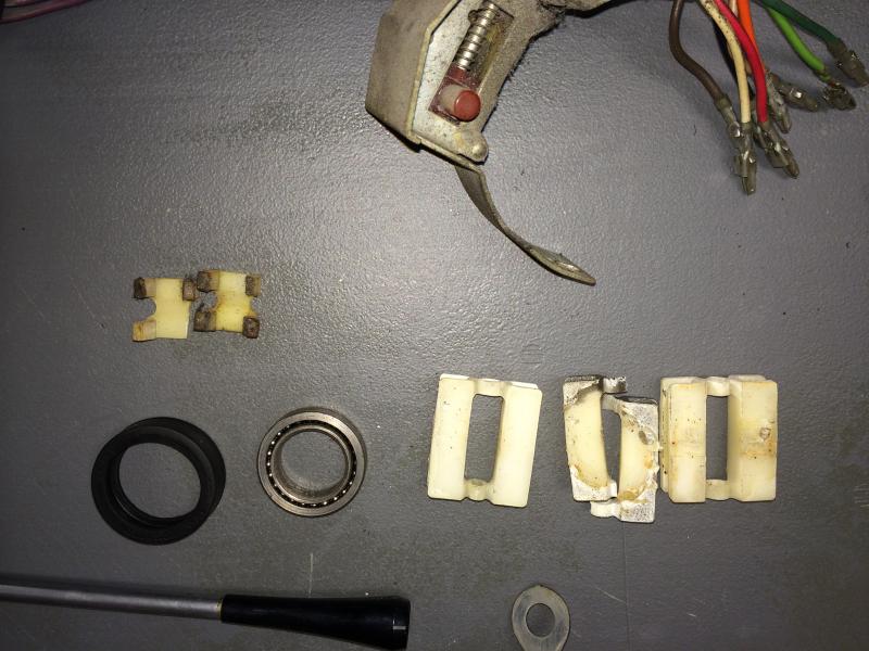

Hi 1968Sublime...the bearing at the bottom of the shaft will slide off but you will have to get the shaft nice and clean, since it's old the plastic is brittle so care should be taken but it will slide off. I'm looking at all your steering column parts and I don't see the shift lever spring, was it there?
OMG you are good! NO shift level spring in the pictures. It was not there when I disassemble the column. Do you have one you would offer up????

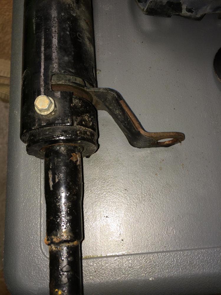

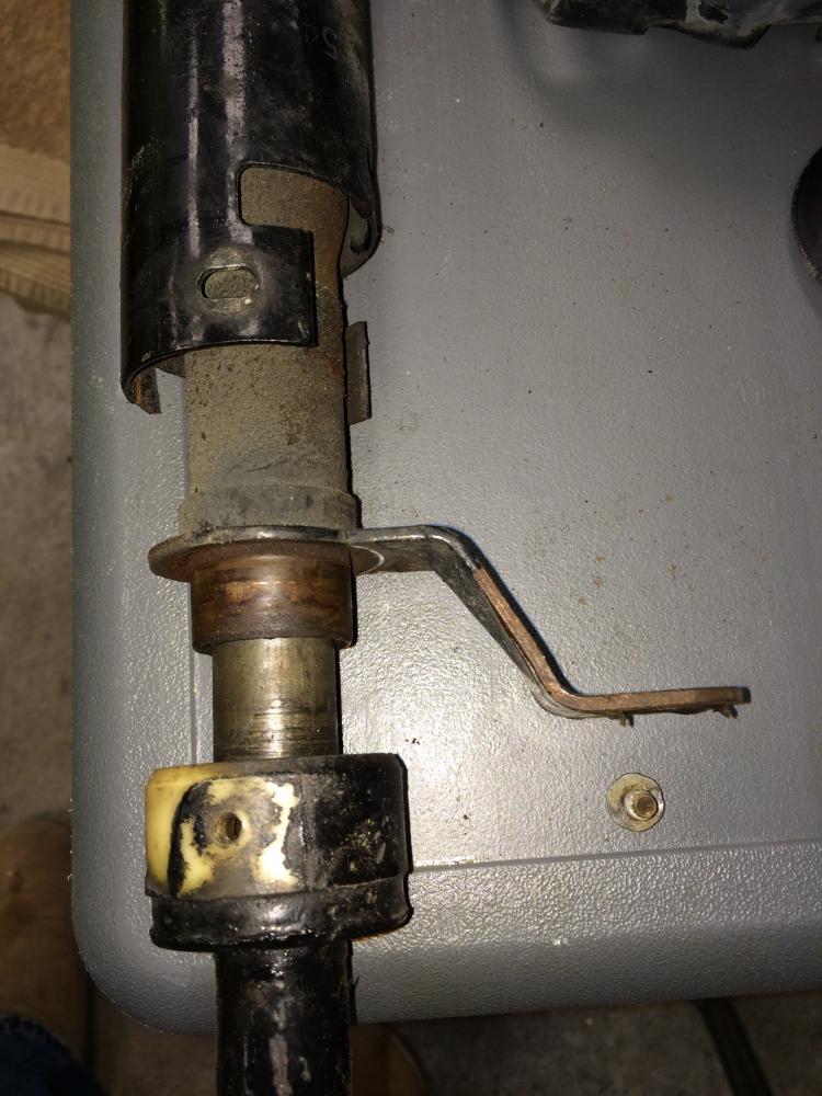

Ok Okiemopar,
I think I figured out what you are after. Here are pictures of the inner tube on lower/engine bay side of steering column. First picture is of it together and then slide apart. The tube slides into the plastic shell of the lower bearing. No gasket or bushing, at least on mine.
Hope this helps you!

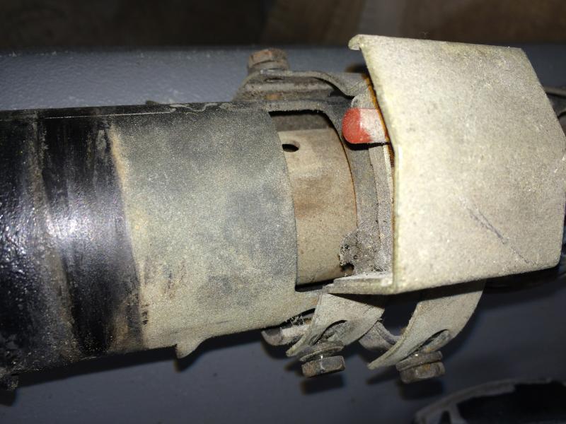

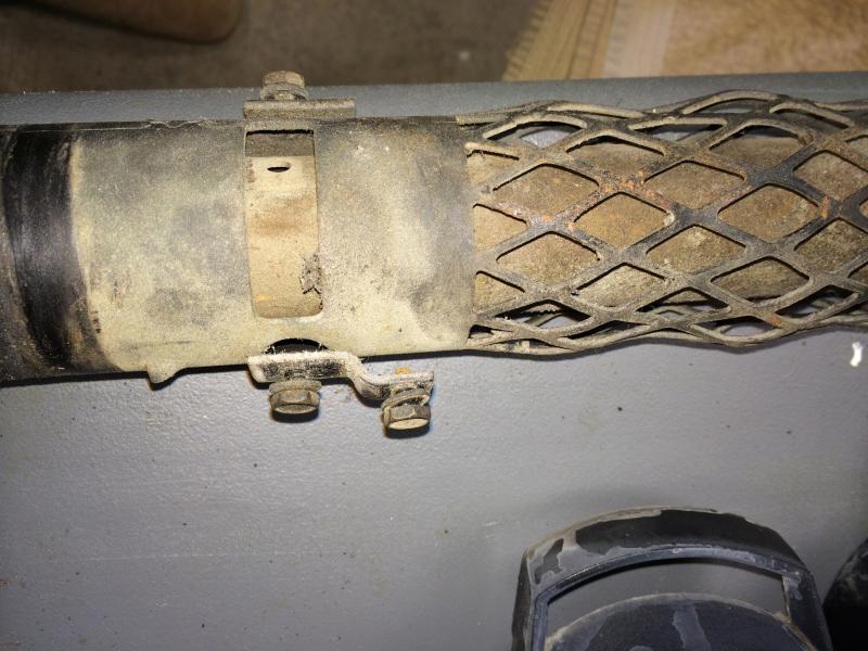

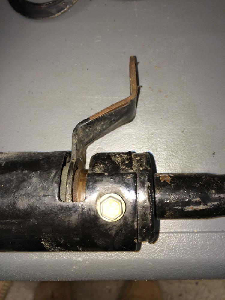

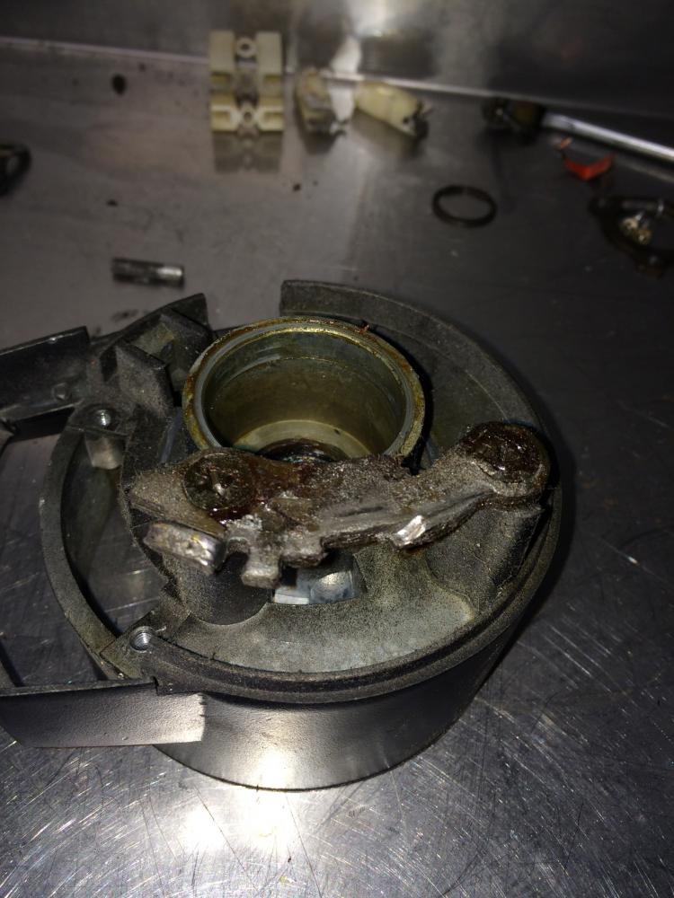

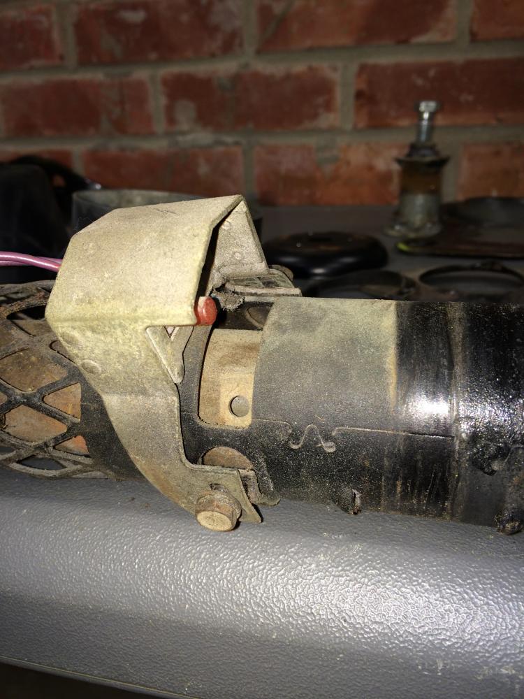

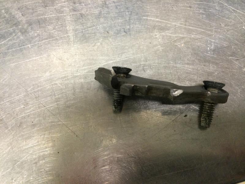

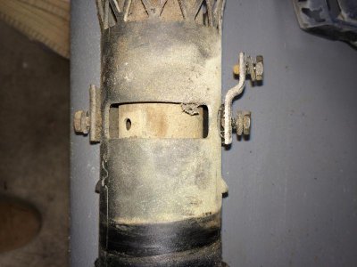

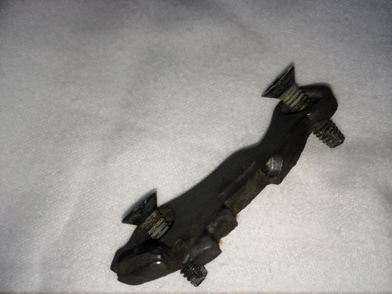

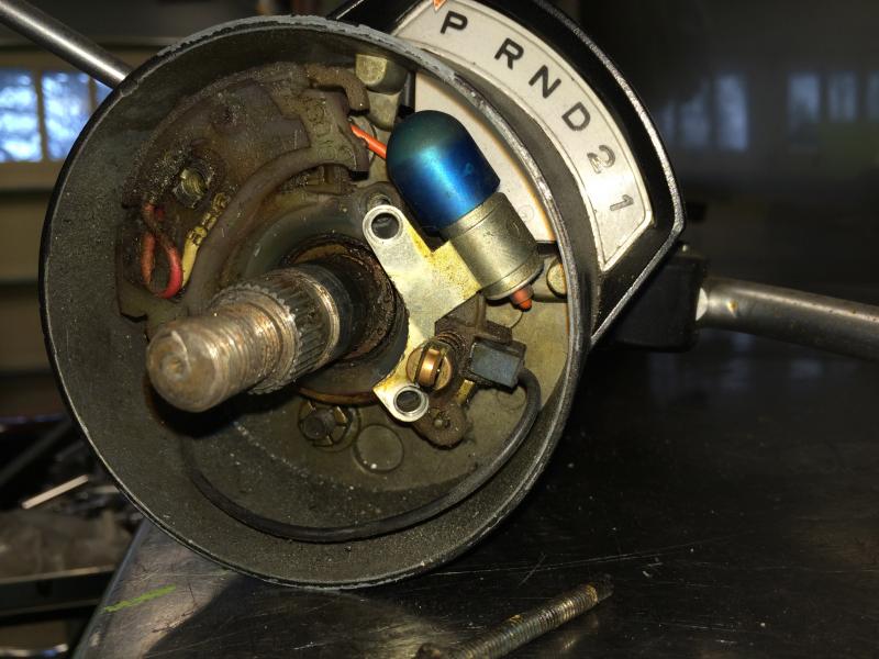

Can anyone help me with what the part looks like or where to get one for the reverse light switch lever? I have the switch,not the lever. You can see in the pictures a hole in the tube at the switch location. What goes here? It was missing off my column. explains why the reverse lights never worked...haha. I have called around and with no success of finding one or even what it looks like.
