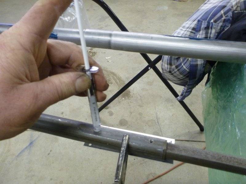

I've often wondered about those plastic pins on the shaft ... are they pins that run right though the shaft or are they just inserts that keep it tight - in which case there can be in/out movement in the shaft with a bit of force.
Safety shear "pins". So the column will stay in place, but collapse when you're jammed against the wheel.... I injected plastic mender into mine.

I've often wondered about those plastic pins on the shaft ... are they pins that run right though the shaft or are they just inserts that keep it tight - in which case there can be in/out movement in the shaft with a bit of forcing didn't hammer

My 69 RR didn't have thru 'pins' but rather 2 channels 4 inches apart where the shafts overlapped. The melted plastic filled the channel all the way around holding the inner/outer shafts together.
