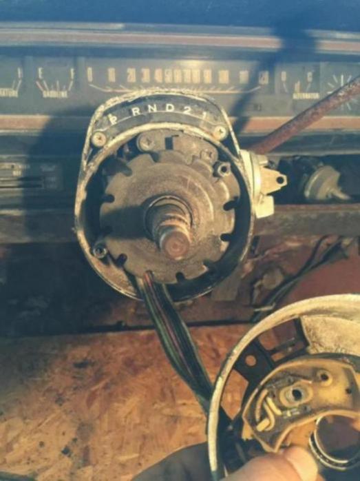

Thanks, both of you. Yes I'm gonna do the latter(if I can!). I came up to this blade looking thing and it's on the pretty good. Locking plate I'm guessing since the tab under the gear indicator appears to slide down into it when the key is in lock position. Any advice on removing it? Gear puller? A crowbar didn't do the trick and actually just pushed the housing stuff more forward! Once this things out of the way I should be able to get to the rest of the wiring

Haynes manuals are worthless I wouldn't use one to wipe my @ss with ! Stick with the factory service manuals and advice of the members here,good luck.
Am I missing something? I got the sleeve off and I can not get this roll pin out. I've got a screwdriver the same width as the roll pin that will fit into the roll pin housing tube. But hammering on that pin with a bfh and pb blaster isn't doing anything. I even tried the propane torch!
Right tool for the job. Invest in a set of roll pin punches. Work much better than screwdrivers.
The roll pin punch fills the cavity completely and pushes the roll pin out, a screwdriver has a chance to mushroom the pin.
