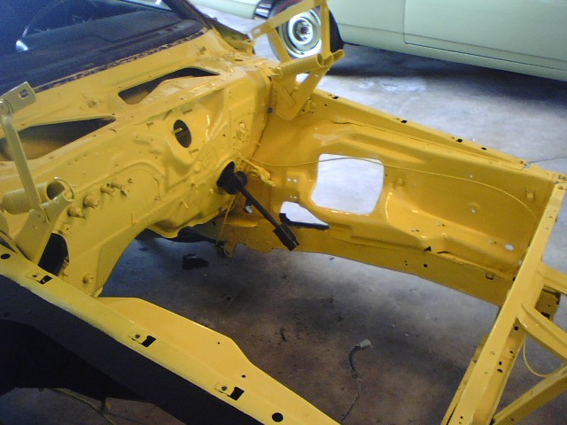

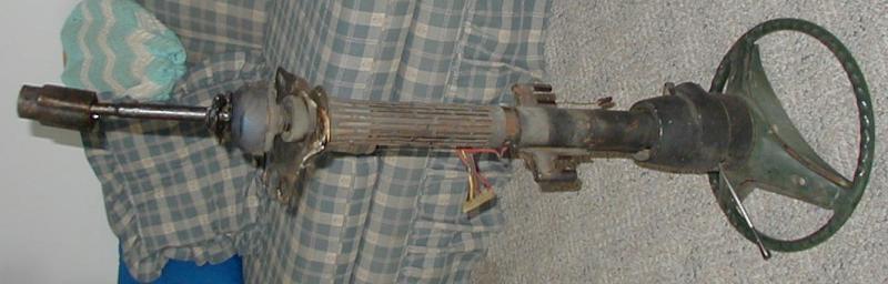

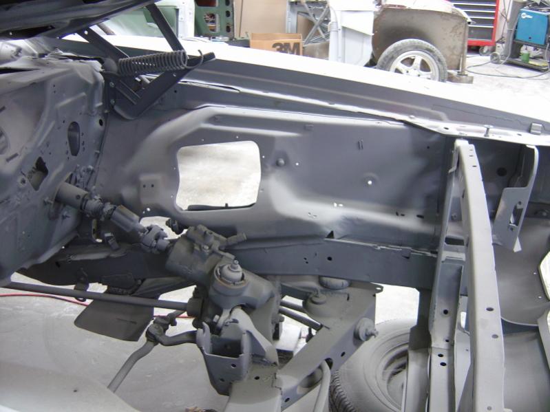

here you can see some differences... 2 firts pics are 74... 3rd is 73... aside the column shifter assembly difference, you can see how diff is articulated.
The big round piece on 74s is actually a metallic shield to protect a thin rubber coupler inside, similar to GM or Toyotas, way different to the Big Puck rubber coupler used on 73s
Dunno if you can also note the firewall cut out difference. Hard to see but is there
