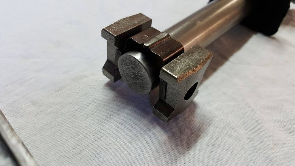

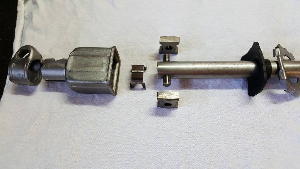

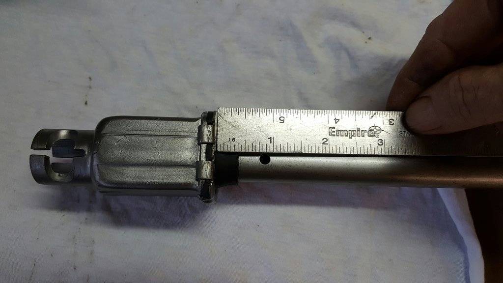

Make sure you have the spring clip in correctly between the blocks. 13/16" is correct. These are pics of my '62. The inside parts are the same as yours. Only the housing has changed.

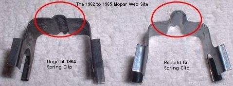

Sounds like your spring is broke. Does it resemble these but in two pieces?
This pic is showing the newer spring that is taller and won't work in the older style housing.

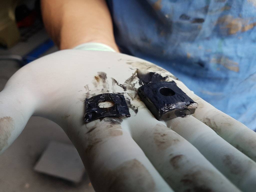

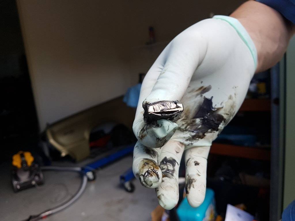

No they are totally different. They are exactly the same size as the shoe, a solid metal piece with a hole in the centre that locates over the pin at the end of the column. They aren't flat - the 2 sides raise up to a plateau which provides the spring action, in the same way as the linked springs in your photo. I'm about to pull it apart again so I'll take a photo.

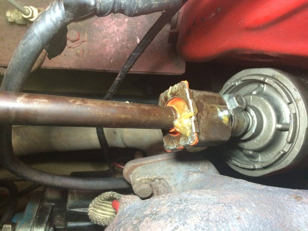

All back in, no slop, feels really great actually, a win for once!
