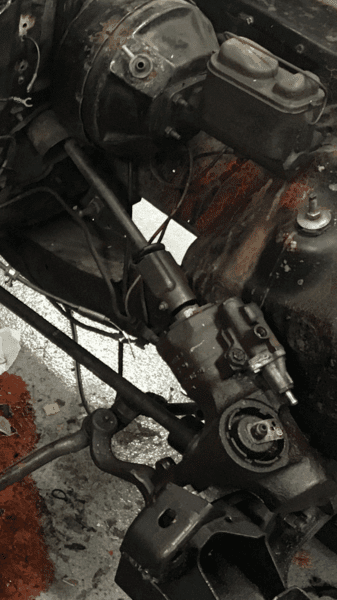

This is how it looks...
Here's another picture where the aligning problem through the fire wall can be seen....

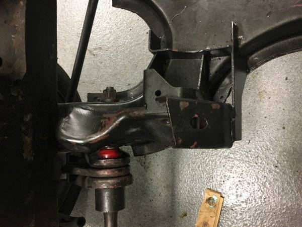

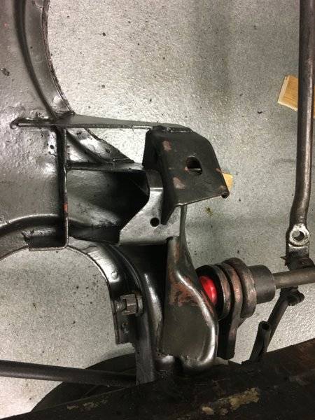

I don't know if it helps or not but here are some pics of the steering box/k-frame on my 66 Satellite which I'm putting back together. It's a 318 Poly car.

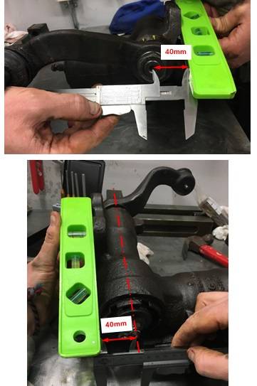

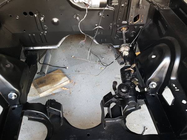

I still can´t find anything wrong with the k-frame.
The three mounting points seems to be parallel and the offset on the steering gear box has the same measuremenet.
The mounting holes at the steering gear box is in line with the steering gear box shaft (the second picture).
