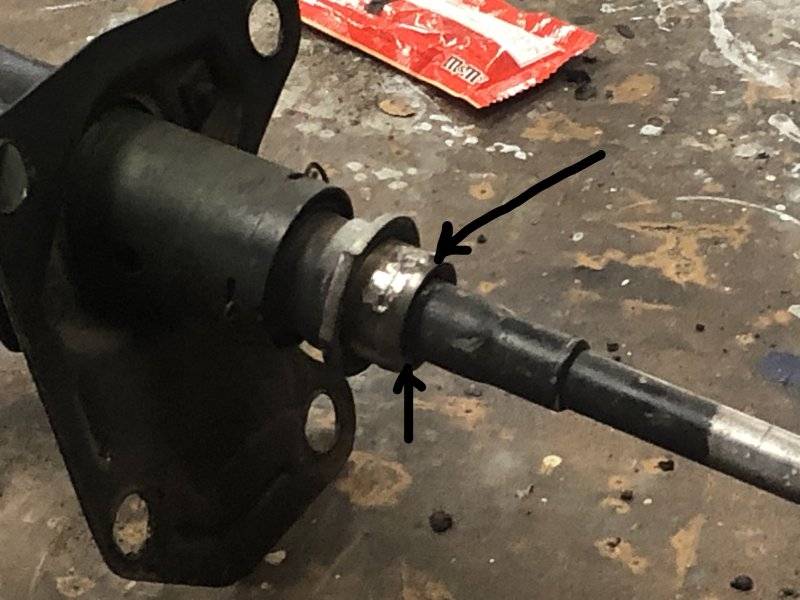

The lack of self centering is mostly found to be an alignment issue where the car is set to factory specs. Back in the days of Bias Ply tires, these cars were aligned with very little caster. Caster makes the wheels want to point ahead and it helps the wheel return after a turn. I've also found that if the column isn't properly adjusted, the inner shaft can rub the outer shaft, binding it a little and also making it difficult to return to center.
Look at the photo below and see where the black arrows are pointing?
I think that there is supposed to be some type of bearing or nylon collar there to keep the shaft centered. Mine was missing so I tack welded a small bearing there in mine.

Also decided to try and adjust the gear shaft adjustment in the service manual and maybe that may help. Who knows what was done when and IF the box was serviced.... That nylon collar is there and in good condition.

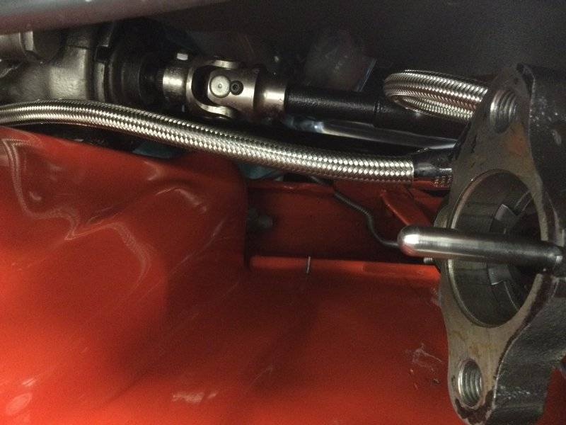

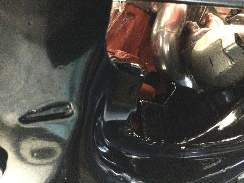

Whelp after talkin to Hydratech (thx Jim) it seems to be the box which also has a ton of slop in it. The pump works as I have brakes so it isn't the pump or anything else so time for a box. My current OEM box is hitting a header tube so thinking I am going Boregeson since it will gimme some room with the Hemi. Hope there isn't much to do to make it fit since I oddly I already have a Borgeson coupler. The current box is smashed up close to the inner fender where it screwed the paint pretty bad I guess when they um assembled the car. . The other spot you can see it is in direct contact with a header tube so everything can nice and hot. So I am thinking of getting a Borgeson box for space consideration and hopefully the shaft isn’t too short. Thanks Scott (I am in NJ)
