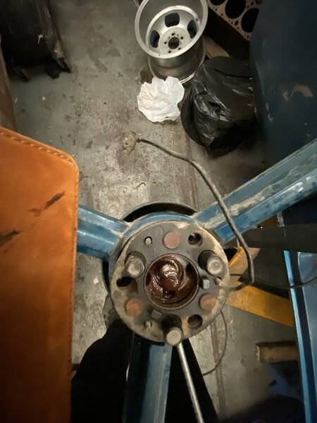

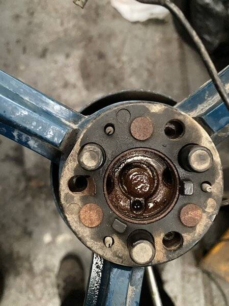

Hi how can i remove this wheel? Do i need a puller? Thanks
7D6E923B-AC83-45F3-9F38-F168911E3750.jpeg 9E196E68-DC89-464D-8539-4433940E12EF.jpeg 74F8EB7D-06B5-4BAC-B98E-BC80ADA39EB4.jpeg 5954CE50-56AC-4357-A342-0236D6092DAC.jpeg

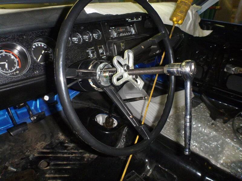

You just need a basic steering wheel puller and 3 bolts to screw into the wheel itself. Cant remember what size they are off hand.
Take the 3 screws out of the horn contact ring to remove it and then it will be obvious.
