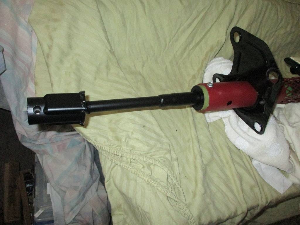

Depends on the plant....Lynch Road dipped the shaft with coupler in semi gloss.....up to the level of the lower busing
Of course dipping would be a waste of paint but it can be mimicked sprayed...
I use dupli color "low gloss" engine enamel.....Then I use a space heater to bake it per se....
Thanks Justin very nice work.
