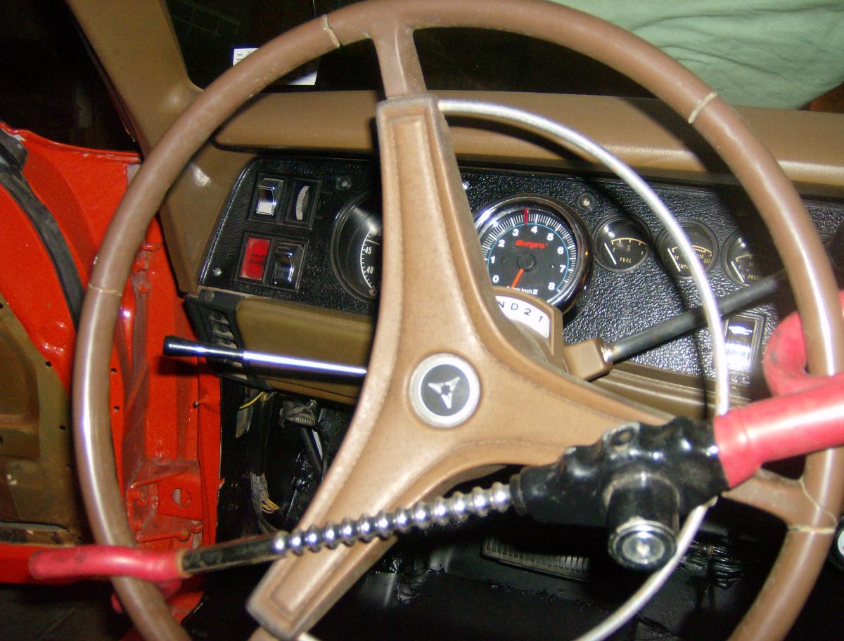

There are several wheels available. Post a pic and we can give you a definitive answer
69 Charger Steering Wheel Removal
Here is the wheel. Does this snap off ?
Carefully remove the dodge medallion and there will be a 7/16 bolt under it. That gets the pad off. 3 screws (phillips) for the horn button, and a single nut for the wheel. 11/16 or 3/4. Don't remember which
1969 Dodge Charger Steering Wheel Removal
Thank you, I appreciate the help.
After this use a gear puller .. although i have just jerked some of them off in a pinch (oops)
Once that is done (and be very careful prying out the plastic madallion). Remove the two small phillips screws for the wire cover plate on the bottom of the column. You will also need to remove the connector harness to fish the old wires out, and the new ones in the column. Make sure you write the color sequence down before you remove the connector. A small pic is used to push the retaining prong on each wire connector, making removal easy. Good luck.
