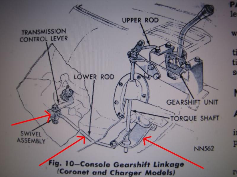

Hello, I'm still searching for trans linkage for my '66 Satellite with automatic console, 727.:angryfire: Please help! I've finally got the newly rebuilt engine running but I can drive it with no shifter linkage!
I've got the verticle shaft from the console but need everything that attaches to the tranny arm. Kick-down linkage would be cool too.
Thanks for any leads, Ian
Take a look at this Photo.....

The bracket that holds the torque shaft will fit from all floor shift cars including any Abody. The lower rod you should be able to manufacture something till your able to find the proper one.Its the Kick-down rod you really need to worry about,without that you'll smoke that trans in no time....and not just anyone will fit you need to have all the proper bends and length as to get the proper throttle ratio. If someone here has the proper one and took a pic that would at least help you know what one you're looking for. Sorry i have nothing in the way of parts to help you ... just a little info.

There are two different brackets for the rear of the trans for the vertical torque shaft be sure you get the correct one
Bracket
I agree x2
Jeff
1 - Gearshift Control Torque Bracket, Lower w/Auto Trans Floor Shift
Used on 1966-74 A and C-Body, 1966-70 B-Body, and 1970 E-Body .
2 - Gearshift Control Torque Bracket, Lower w/Auto Trans Floor Shift h
Used on 1971-74 B & E-Body.
