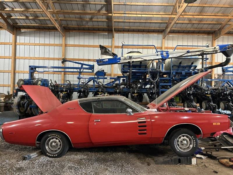

I saw this ad back in September, one picture from the front in a storage unit, non running unfinished project in a storage unit but because of a lot of factors that added up I didn’t see it for a couple months. The seller was very nice once I actually got in touch with him but really didn’t know much about it other than he bought it about 15 years ago and had bought some parts for it over the years but lost interest. Price was firm but from what he told me on the phone, including that it had hideaway headlights and the “fancy taillights” and stressed that it was originally grey and not red but glossed over that it had door decals, I was feeling like his price might be just right.

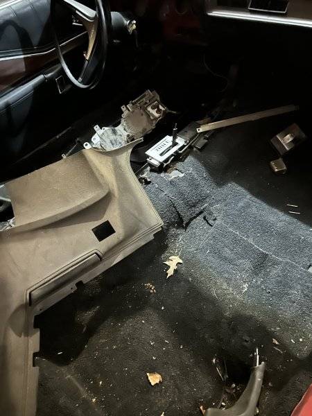

I finally brought it home and it came with a 440 and 727 I’m hoping to get in it by spring.

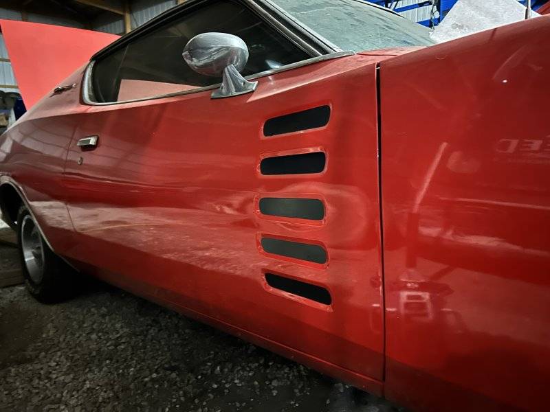

7-19-72 engine block date, so my deduction is a ‘73 model year Charger. Possibly a Rallye package, but hey I’m no expert!
Looks like a lot of work ahead of you so good luck with the SUV……Storage Unit Vehicle.
If it has "fancy" tail lights, those are 72.
Hood has no emblems, which if factory could denote a 318 car.
Door "decals" but no mention of indentations.
Has 72 style hood blackout.
Hidden headlights would be 72 as well.

High 4 Digits. I can’t speak to it being on Facebook. It may have been, it was about 75 miles from me and the person I bought it from bought it from a guy that actually lives in my town. No engine or transmission or interior in it but they all came with it. All the parts are there to put it together. I started by putting the emblems on. Paint is driver quality, I haven’t cleaned the dust off but it should shine up, but no rust and several scratches and a couple dents.
That is a great find today especially since it looks so solid. Congrats!
Nice! Factory 440 car?
Small block. The 440 that came with it and should be a runner from what I can tell. I’m trying not to buy any additional parts unless absolutely necessary so I’m using parts I have and parts that came with it. Put an intake on the engine, it’s been apart at some point as it has 12 pt head bolts and roller rockers along with MSD distributor. I had some headman headers and a rebuilt steering box. I did buy the rest of a CVF drive kit and an AC compressor as the engine had a crank pulley and water pump pulley on it.
The drag link was on wrong which explains why the wheels were not remotely straight. It does have new tie rod ends, sway bar bushings and upper and lower ball joints but needs upper and lower control arm bushings. Parts to rebuild the front and rear brakes came with it but I don’t know if there is actually an issue or they are just rusty from sitting and the PO just bought them because they looked bad.
