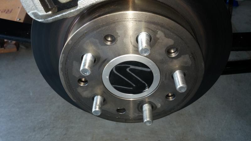

Does anyone out there have an S60 and if so do you notice that the center cap of the axle does not protrude through the center of your rotor/drum? I was wondering if this is correct and if so, am l to assume that the studs and lugs are the only thing centering the wheel on the hub? 0923151023.jpg

Thanks for the response. Talked with reps from Strange and Summit and they claim it is supposed to be flush with the end of the disc or drum with nothing protruding.
Hi Guys', ma-mopar originally piloted the wheels on the axle pilot in the rear and also piloted to the drum in the front. This would be the correct way to assure wheel concentricity to the axel or spindle. As Mocajava surmised the aftermarket wheel and axle manufacturers wanted to create universal components to fit a wide range of vehicles so the components often neglect the center pilot feature. Using the studs to locate the wheel will work fine in most applications. Street cars, bracket cars and cruisers utilize the studs for location with no apparent issues. If you are planning on going real fast, piloting the wheel concentric to the axel axis is more of a requirement. Without a pilot I have found it helpful to carefully install and torque the wheel, set vehicle so the tire is just above the ground and use a magnetic base indicator with a piece of scrap and do a rough check for run-out. This can save a lot of time looking for that tire that's out-of balance. I have seen some assemblies that could be improved by indexing the wheel on the studs. If indexing the wheel on the studs nets improvement don't forget to mark the wheel and stud. Lastly we had a set of off shore wheels come in for an OEM that were almost a 1/4" out of concentric. A careful look at your parts can save a lot of headaches. Just my thoughts, Brian.

I've never found wheel studs not be concentric with the axle center more than a few thousands of an inch but have found plenty of wheels and tires to be out of round. Axial run-out on wheels is usually worse than radial run-out but generally isn't that bad but have found radial run-out on some tires to be more than a 1/4"! Used to know a shop that had a tire truing machine but don't know anyone with one anymore.....
