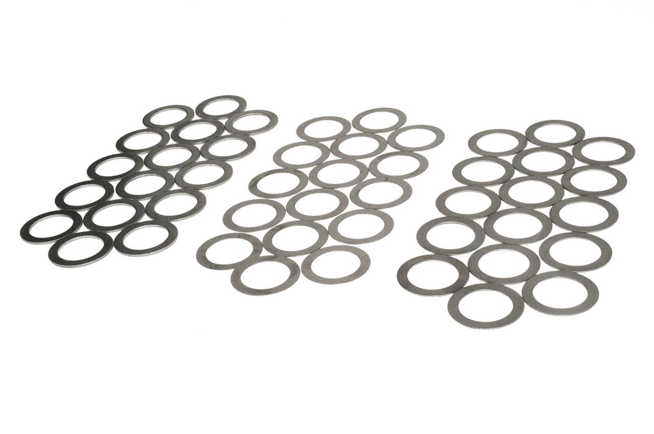

I run the Mancini rockers in my 318, i run a bit more cam than you are planning in that 440 and haven't had any issues... when you order the rockers also order a shim kit with various sizes, i spent a hour or so pulling/installing the rockers to get the side clearances right (i believe it was .012-.015).. put down the middle stand off first then work out to each end (fastest way i found to do it)
Just posting this to help save some time when you put it together.
