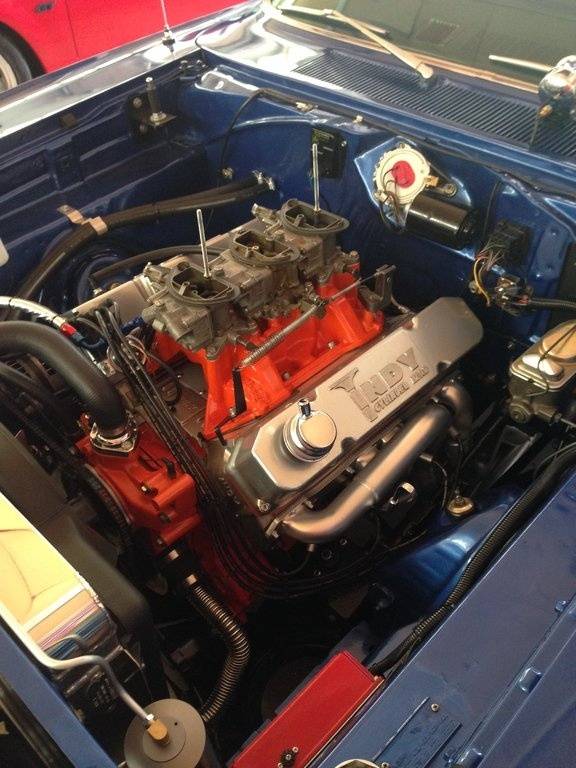

The source kit is nice. I used one in my 511. Probably one of my most favorite engines I've built for myself. Drives around like a 12 sec car untill you cut it loose! Here's a link to the build
http://www.forbbodiesonly.com/moparforum/threads/roadrunner-8-4.101032/
