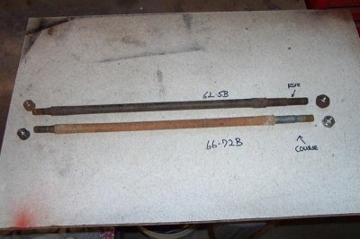

Actually 62-5 are different than 66-72B/E

Really!? Your gonna bring up the difference in thread pitch? The length is the same and that is what counts
