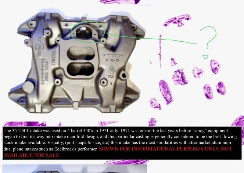

What goes here on a stock intake? I’ve really only dealt with aftermarket edlebrocks and they don’t have this?
I’m running a Holley 4150 series carburetor. Is there a block off plate I can buy? I did a web search but nothing came up for a 440 Mopar stock intake.
No need for a block off, leave it as is. You can buy a valley pan gasket with a block off for the heat crossover.
You could make one.
