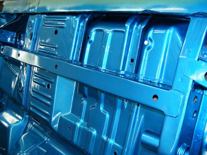

Bought a used bolt in set epoxy painted them in black. One improvement I made was to the rear mounts the bold holes were dimpled in towards the rear frame box so I straightened the holes and took five sixteenth (?) bar metal drilled two holes in each so when the stiffeners are mounted the bolts will less likely dimple the stiffener as will the box. I'm going to paint the bottom of the floors first before installation. This summer has been super busy with house and yard projects with little time to work on the car.
