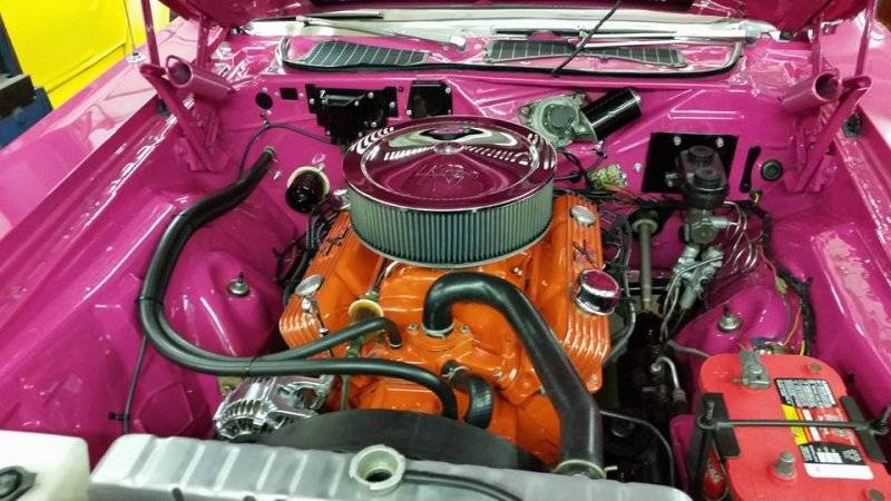

I've used etch and epoxy. use grease and wax remover to clean, not paint or lacquer thinner. Single stage urethane car paint is the best. I have motors that were painted 20 years ago. This small block was painted 17 years ago. Aluminum intake, timing chain housing, water pump, and valve covers. Race motor 10 years ago. All aluminum except block and bondo filling pits.
Doug
