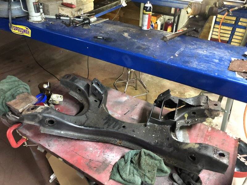

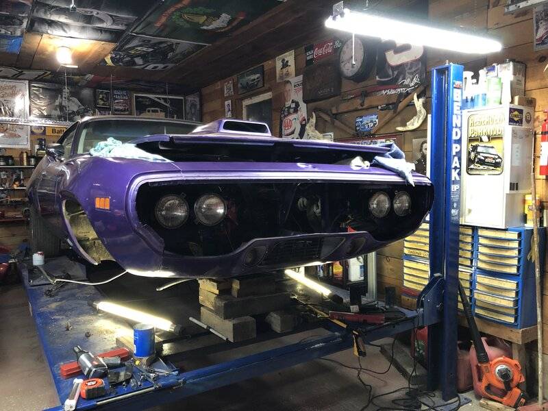

I’m starting to put parts back on my 71 Satellite Sebring Plus that I've had since 79 and I really would like for it to handle as well as my truck, haha. What I’m looking for is a total package, bushings, ball joints, tie rod ends, torsion bars, rear springs, and etc. I know all of this has to be designed to work in unison or it’s a waste of time and money. If any of you folks have a suggestion or have had great results with your build I would greatly appreciate some advice and where you ordered it from. Thanks in advance, your help would be greatly appreciated.

Thanks guys for your posts, all super advice. I’m putting in bushings, ball joints, everything that can be changed. Stouter torsion bars, lower control arm plates, torque boxes, subframe connectors, rear springs and such. Everything is original and is tired, the only new thing was a steering box from its last go over. I realize with all new parts it will be a different car, thanks for your time it is greatly appreciated.
