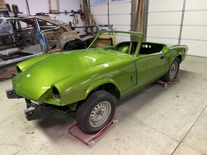

Here is the Sour Apple BC/CC I just shot. (Sorry not a MOPAR, mine is in the back undergoing serious floor/roof/side repair)
Something to consider.
