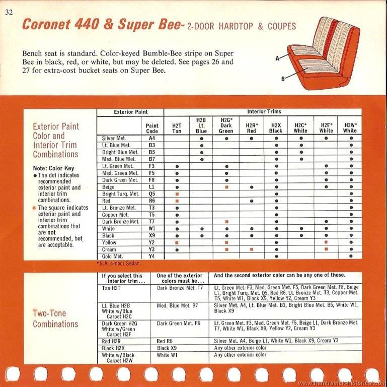

Well, different than some Coronet models, but not specific ONLY to the Super Bee. Standard Super Bee interior was shared with the Coronet 440.
