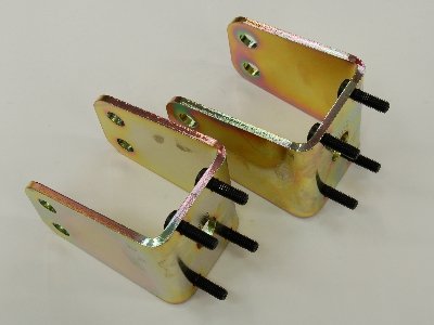

this off Mancini web site.. you do have to change hangers, if you don't change hangers your drive shaft will not fit
Product Description
Fits: 1964-65 Dodge B Body with Super Stock springs.
0.250 material. Hanger is one-inch longer than stock so the shorter SS springs will fit properly. 1964-1965 B-body cars use a leaf spring with a 21 inch front segment. The Super Stock springs have a 20 inch front segment so the spring hanger needs to be one-inch longer. These hangers are the correct length and they have a second eye-bolt hole so the ride height can be lowered by about one inch
Item# MREAR0079

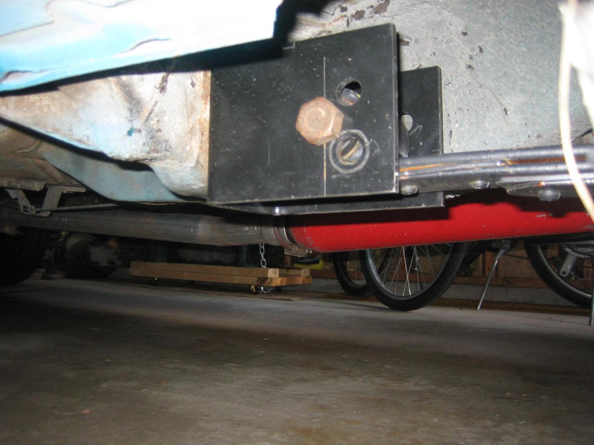

I had to use the new hangers on my '64, but I had to drill a hole 3/4" forward of the holes provided to make them work - due to the drive shaft length. It still worked, but there was a nasty vibration that made me realize I had lost the play in the shaft because it was stretched to it's limit. That extra 3/4" made all the difference.
