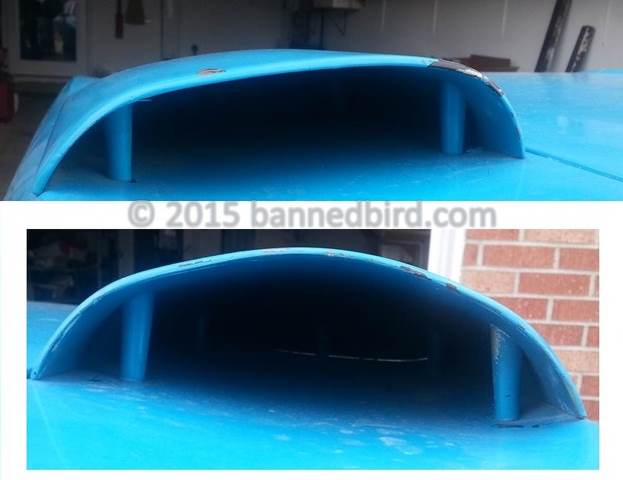

I bought two reproduction fender scoops (Stinger) but yet to compare them to the originals on my car. In the past year I found evidence that Chrysler had two different style fender scoops and some 'Birds had one of each. My car appears to be one of those. Once I pull off the original scoops I will compare to the repro's.
I have not done much research on fenders, rear plug, or the other parts.
Facebook.com/bannedbird has pictures of the factory scoops and will show the nose project.
