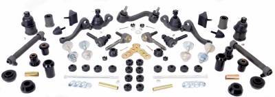

Anyone replace their old suspension bushings, ball joints and tie rod ends? What brand kit did you use? Are the original rubber bushings better than the new style neoprene bushings? It is time for an upgrade, I just need a little direction. Thank you!
Got mine from PST, haven't started putting it together yet, polygraphite kit.
Does it look like a high quality kit? How much was it? Ball park if you don't mind me asking?

I used all Pst upfront, upgraded to the bigger solid sleeve tie rod adjuster all their parts are good quality no squeaks at all the ride is good. I made the mistake of not getting the adjustable strut rods. That will be resolved next year along with double adjustable uca.
I've done the pst kits on a couple of my old cars. The polygraphite kit gives a better handling feel, less give than the rubber. But I've done the rubber as well and had no complaints. I'm going with them again on my Super Bee and probably gonna stick with rubber since it less expensive and will be fine for a factory resto. The prices vary by what size kit you get so look them over and see what all you need. They range from a few pieces to the whole thing. All they're stuff is great quality and they're pretty much a one stop shop.

You didn't offend me... It was a little over $400 and it looks like a very nice product! I got the super kit, they have 3 levels and 2 choices of material.
I bought the QA1 adjustable strut rods and LCAs so those pieces will be up for sale.
https://p-s-t.com/i-23160272-polygraphite-performance-super-front-end-kit.html#!year=1967||make=DODGE||model=CORONET

I got the super suspension kit and up graded a few items. The sway bar links look like they are way too long. The originals are 4" and the new ones are 6" long. My kit is the polyurethane bushings. I broke a breaker bar trying to get the upper ball joints out. I wound up heating the A-arm with a torch to get them out. Will that heat compromise the integrity of the A-arm? I have everything wire brushed and painted. I will begin the reassembly Tuesday.
