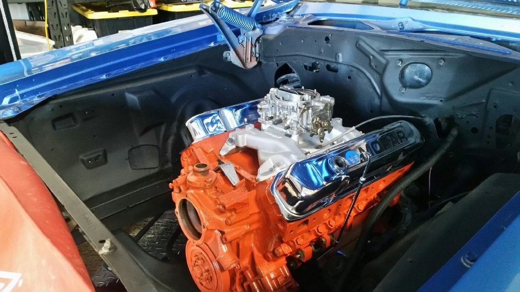

Going from 318 to 383 in a 71 charger right now. Used mounts from Napa for a 1968 charger 383 and engine brackets from a 1969 b body big block
